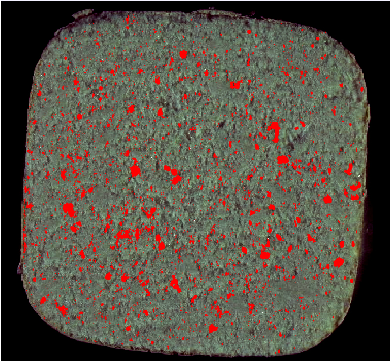

Raman image of a SiC wafer. The images area is approximately 1 mm2, and shows inclusions of 6H-Silicon carbide, 3C-Silicon carbide or Si (red), voids (black). The strain distribution is shown as blue to green.
Binarised Raman image of montelukast sodiumRaman image of montelukast sodium API within an oral tablet. API domains are shown in different colours for easy visualisation.
You can also analyse Raman images to get quantitative data. This includes particle statistics metrics like number of particles, shape or size. In this way, you can quantify Raman images with objective metrics for direct comparison.
