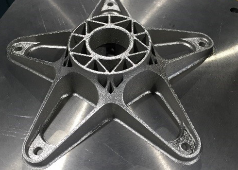

Ryan approached Renishaw's office in Australia with a wheel from the 2015 car comprising a centre machined from an aluminium alloy, and a band also made from aluminium. Ryan worked through several design iterations, replacing the aluminium wheel centres with smaller ones made from titanium alloy by additive manufacturing.

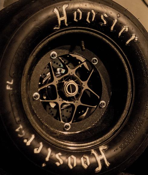

The new design also used a carbon fibre band in place of the aluminium one to give the maximum weight savings.

Guidance in design optimisation for additive manufacturing was provided by Renishaw staff to reach an alternative design with which everyone involved was happy.
Iterative FEA (finite element analysis) simulations were performed throughout the design process in order to predict the behaviour of the new component and to evaluate the benefits that could be gained.
“One of the things that I loved about using the Renishaw additive manufacturing equipment was the ability to increase the complexity of my design,” said Ryan.
“With parts that I had designed for traditional manufacturing methods, I had to be very aware of the size and shape of the cutting tools that were available as well as the added machining time that would be required by certain design features. By 3D printing the wheel centres, I was able to add in fine features that would be difficult to achieve using traditional methods and it cost nothing in extra build time.”
Once the design had been finalised, Renishaw Oceania manufactured nine wheel centres to provide Team Swinburne with two full sets of wheels and an extra wheel for testing. The wheel assembly was designed so that each of the titanium components would require minimal post-processing. On removal from the AM equipment, the parts were stress-relieved in a vacuum furnace, removed from the build plate with wire EDM and bead-blasted. No further post-processing or machining was required.

The new design, with the titanium parts replacing the machined aluminium centres, and the broader carbon fibre band, reduced the weight of each wheel by 20%, resulting in a significant 75% reduction in rotational inertia, leading to measurable improvements in acceleration and braking performance. The additively manufactured wheel centres also contributed to an overall weight reduction of 1 kg per wheel, whilst also maintaining safety, leading to an overall improvement in the car's performance that was evident in the results on the track.

The new wheels “looked incredible” according to Ryan Wise
We looked into some unique tricks, such as printing skins around an internal lattice to reduce weight and to keep the thermal stresses down. Once I understood the process, I found it surprisingly easy to come up with a design that was both light-weight and printable."
