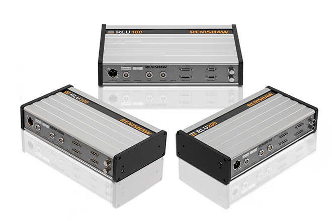

RLU100, RLU200, RLU300 laser units for laser encoders, in a triangular position
