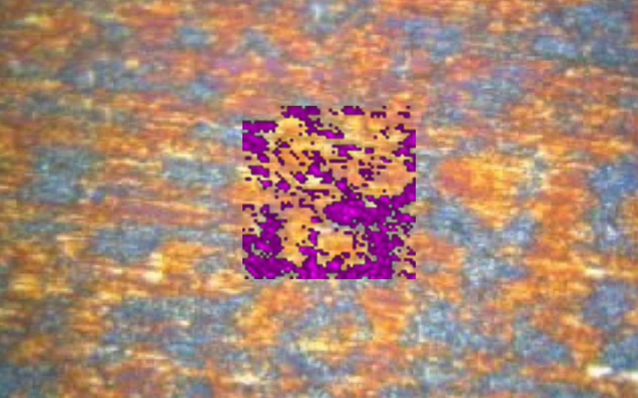

Raman confocal depth profileRaman confocal depth profile. The confocal analysis enables the contaminant thickness to be quantified.
