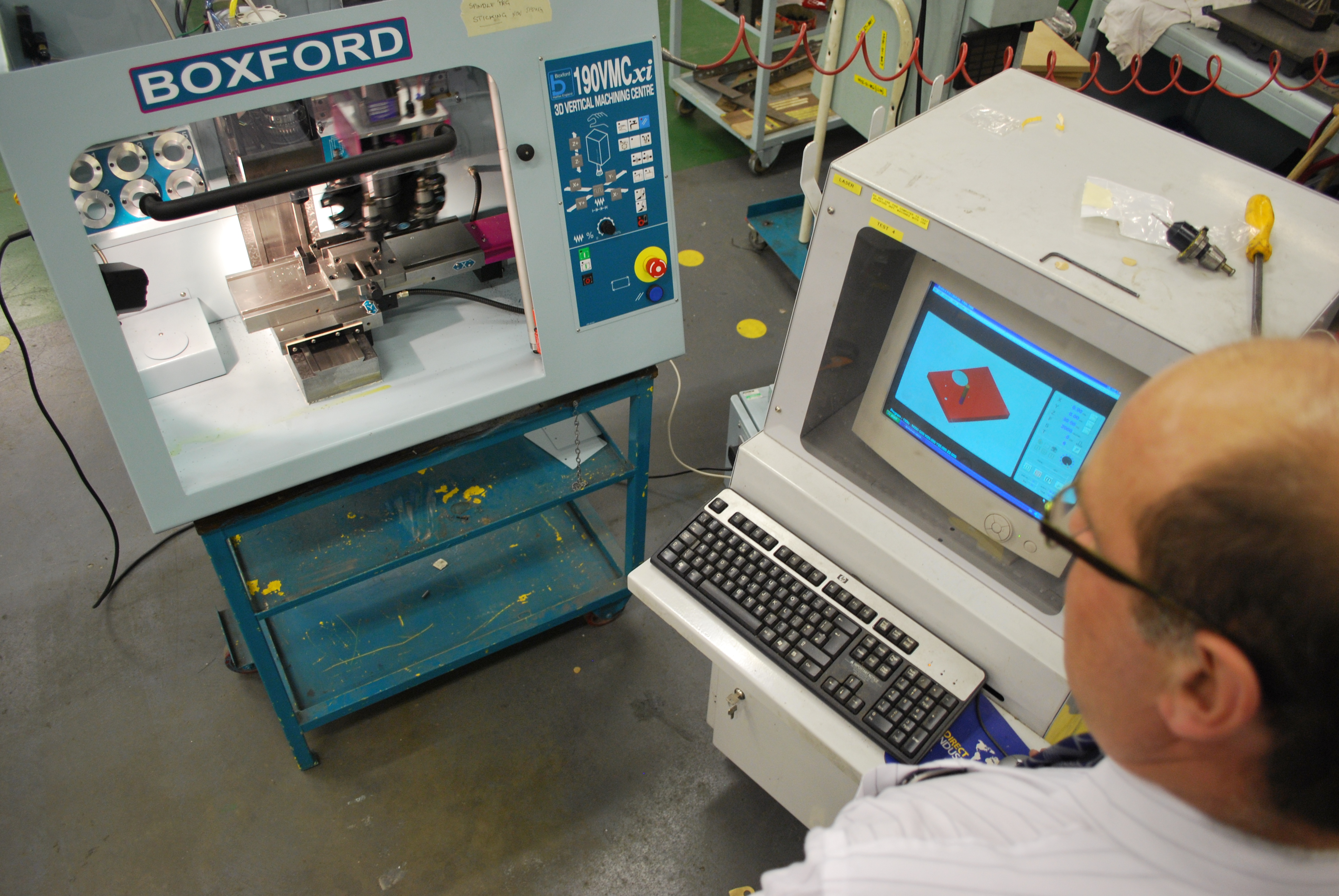

Boxtrees Precision - Boxford machine during testBoxtrees make all the machined parts for a large range of educational machine tools supplied by sister company Boxford, along with other sub-contract work.

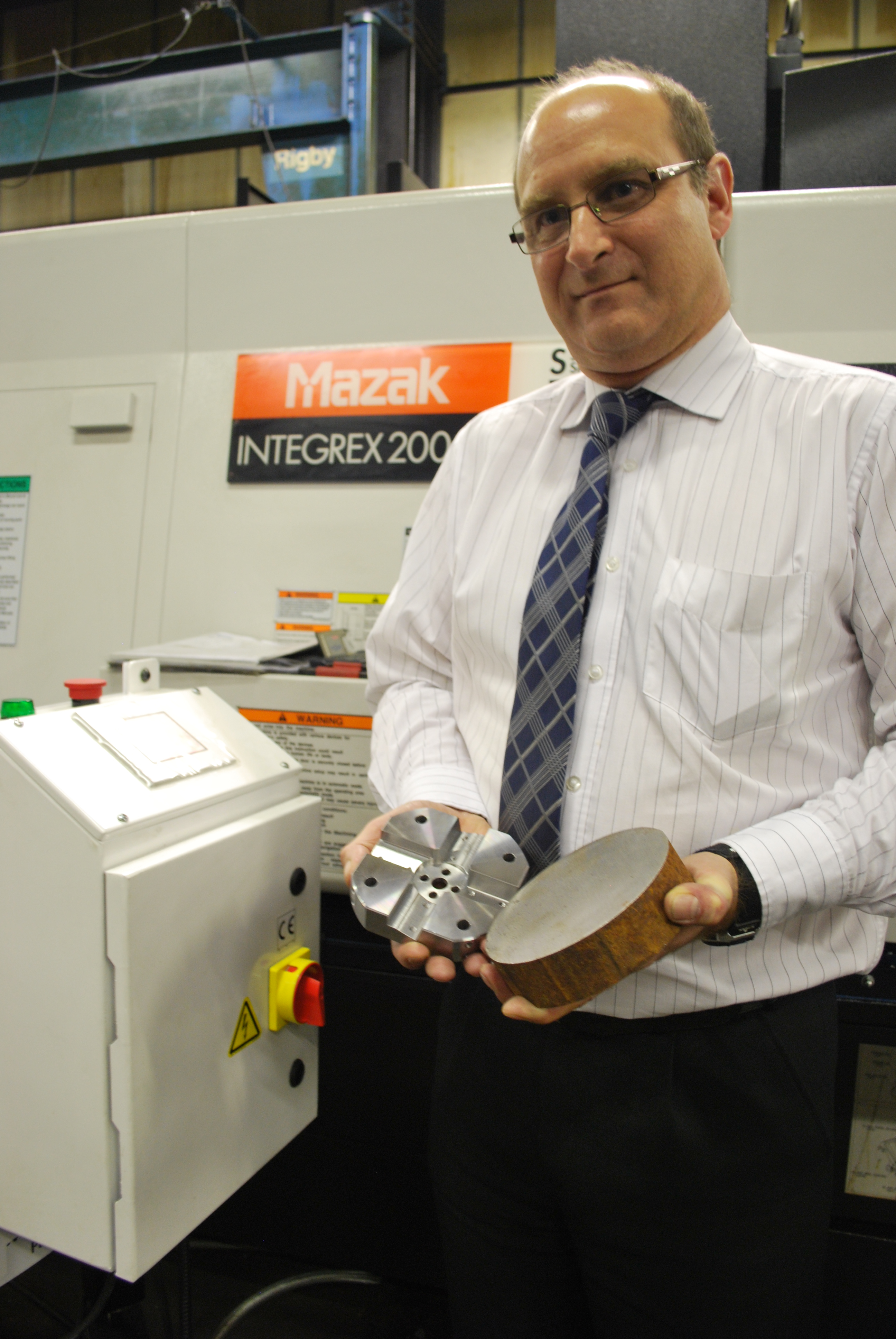

Boxtrees Precision - OMP400 inspecting finishing billetThe Mazak Integrex is used for twin-spindle billet work during the day when the operator is present, with many different shapes and sizes of billets, whilst overnight it runs un-manned, with material supplied by a bar feed.  In both cases final part inspection is performed by the touch probe on the machine, with measured values recorded in a text file. This is fed back to the production scheduling system as a permanent record of the critical dimensions of the component and whether any feature was out of tolerance i.e. a scrap part.  The OMP400 is an ultra compact probe, ideally suited to multi-axis machines thanks to innovative RENGAGE™ technology, which brings unrivalled  3D measurement performance.
Billet work during the day
Boxtrees Precision - billet and finished partThe dimensions of each individual raw billet vary considerably, often over or under size.  The first operation after it is loaded will always be to check the billet length using the OMP400 touch probe, which is loaded into the machine spindle from the tool changer, like a cutting tool, when needed.  In some cases the billet can be over size by up to 8mm – the program changes the number of cuts used on the first face accordingly.
If it is undersize the billet is rejected before the machine wastes time attempting to cut it.  Features on the billet may be measured by the touch probe during the machining cycle, for example checking a bore before adding a keyway.  Critical features on every finished part are inspected to decide whether the part is within tolerance: in some cases extra datum features are actually added to the design to enable easy measurement of the critical features.

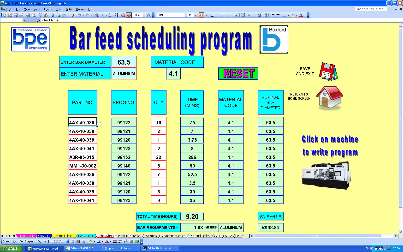

Expensive scheduling software?
Boxtrees Precision - Scheduling system for overnight workWhat is the scheduling software that can do all this - surely it must be expensive?  The surprising answer is Microsoft Excel.  The key to such a comprehensive system is actually just the creative thinking and logic employed by Steve Randerson to bring all the data together and control the process, using spreadsheet commands.  The same document within the program includes many functions, including recording orders received, measured values of finished parts, SPC analysis, and a database of machining programs.
