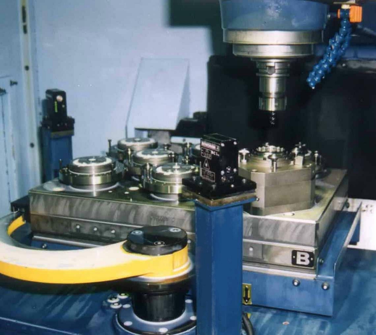

Mr Radley first saw the NC1 laser system when it was launched at the previous MACH exhibition, and was sufficiently impressed to have it installed on a busy twin-pallet Matsuura VMC. The most valuable aspect of the non-contact NC1 system is its ability to check the diameter and length of each of these delicate tools totally free from any operator involvement. With cycle times per load as short as 35 – 45 minutes, and with the company running a two-shift system, the time saved with the automated system is considerable.
Tool breakage detection
"Added to this", says Mr Radley: "The automatic checks for tool breakage at rapid feed rates and the ability to check each facet of a multi-faceted tool, has helped bring significant reductions in the need for rework, and has also helped to further raise the already high levels of quality assurance". In this application, the transmitter and receiver unit have been located diagonally across the table so they don’t obstruct easy changeover of the pallets.
