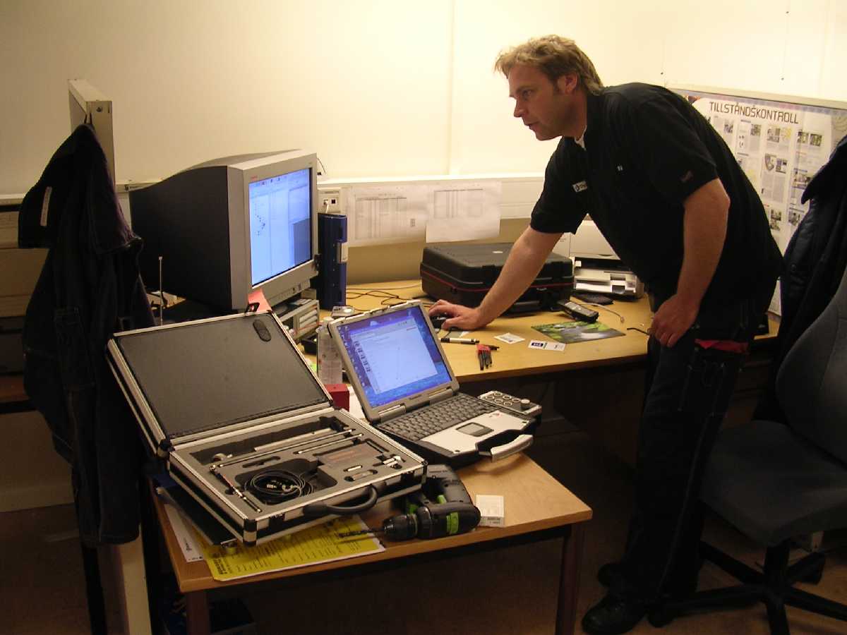

Dynamate engineers testing ballbar resultsKjell Norstedt, Maintenance Engineer for Dynamate, is able to prove that the machine tool itself is often responsible for process problems, which production staff usually don't want to believe. The first test that he does on a machine often shows errors that weren't known before, and he is then able to demonstrate dramatic improvements. Mr Norstedt explains a typical example -
"One machine producing transmission parts had its program manually adjusted every few hours over the last few years, to keep component dimensions within tolerance. I ran a ballbar test in a matter of minutes and found a circularity error of 948 microns! Using values from the ballbar's analysis software I was able to immediately change the backlash compensation and reduce the circularity error to less than 400 microns. Once I change the motors most of the remaining error will be removed and they won't have to touch the program values again."
