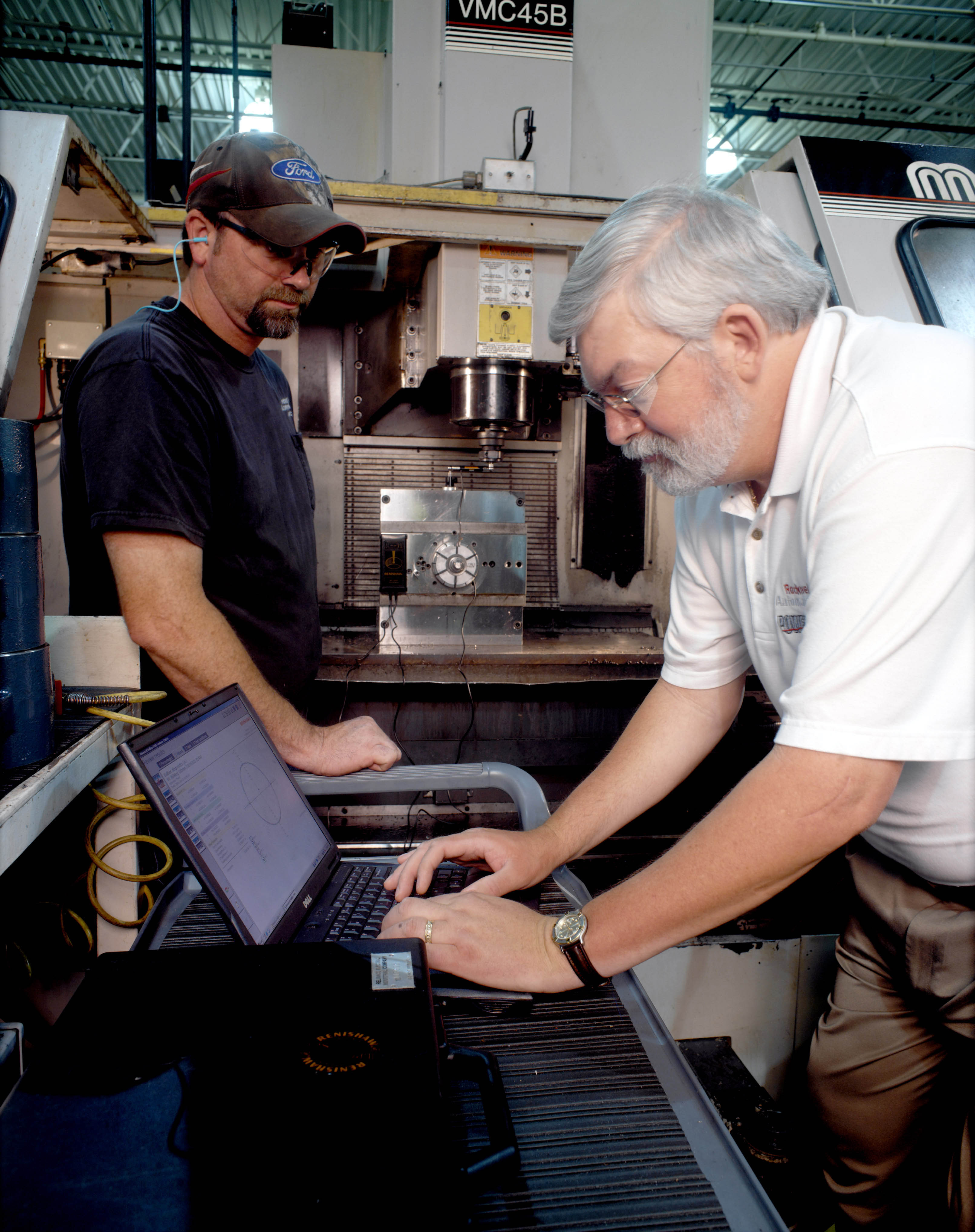

A key tool in the Power Lean arsenal is just that, a tool. "The Renishaw ballbar is an incredibly powerful tool for us," says Larry Sykes, Lean program manager. The QC10 ballbar gives maintenance technicians an internationally recognised standard for assessing the dynamic motion and positioning precision of machine tools and production machinery, he explains. "The ballbar gives us a preventive and diagnostic tool for making sure that our machines are capable of producing to required part specifications."
This provides vital benefits to both Six Sigma quality and Lean efficiencies. "Machine capability is critical when you're machining parts to tolerances in the tenths," says Bill Murphy of group maintenance. At the same time, ballbar tests generate trend data to help technicians implement predictive and preventive maintenance to keep machines functioning properly and part quality within spec.
Periodic 15 minute tests
The ability to do pro-active maintenance greatly reduced unexpected downtime to support the move to high-throughput, lean work scheduling, says Sykes. Ballbar tests are done periodically for performance tracking under the predictive maintenance program, as well as when a machine problem is suspected. "The great thing is, ballbar testing is simple and fast, so you're minimising disruptions and downtime," stresses Sykes. "It only takes about 15 minutes to check out a machine."
Literally a telescoping bar with machined balls at either end, the ballbar attaches magnetically to socket devices mounted to the machine's spindle and bed. As the machine runs the ballbar through a sequence of programmed routines, a precision transducer tracks machine movements. Renishaw software converts the data into a polar plot of the machine's true movement. The software tracks machine movement to 0.5 micron, allowing precise assessment of machine geometry, circularity and stick/slip error, servo gain mismatch, vibration, backlash, repeatability and scale mismatch. The ballbar software not only provides diagnosis of specific errors in accordance with ISO 230-4 and ASME B5.54 and B5.57 standards, but also ranks errors according to their overall effect on machine accuracy.
