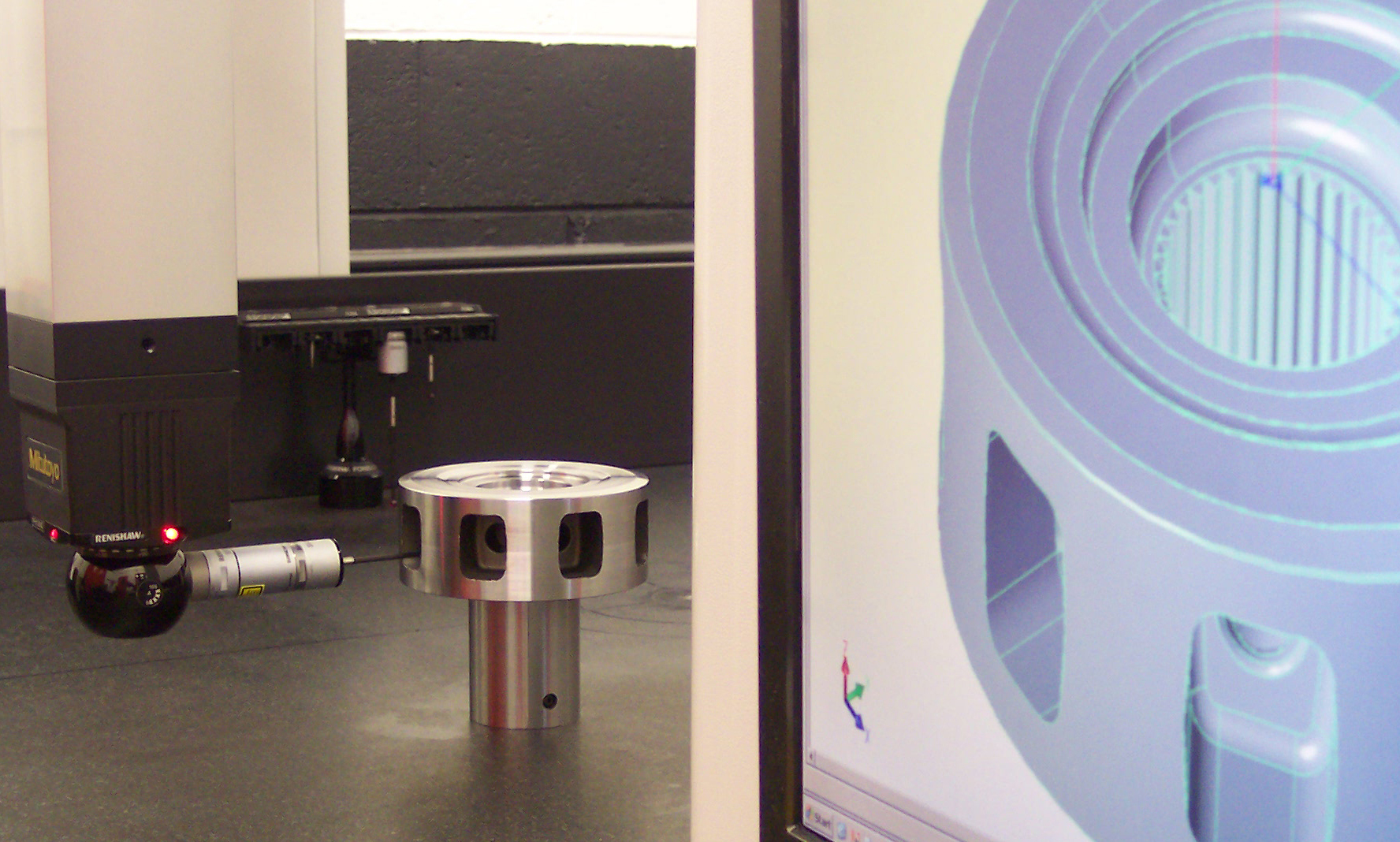

Mr Peace programs the CMM using CAD models, where available, creating programs where the measured points and motion of the probe stylus is visualised on a 3D CAD model.  This programming is done such that the machine operator can run through a series of step-by-step instructions, positioning the component in the right place on the machine bed, then running the rapid inspection cycle in a matter of minutes.  The operator must use a specific password to start running the job and any measured data is automatically recorded against the specific component and batch.
Immediate visual check of profile tolerance
The inspection program immediately produces a plot of measured points, showing the deviation from the nominal line of the gear profile, and how that deviation compares to the upper and lower tolerance limits set by MME and its customers.  Machine operators can see immediately whether there are any imperfections along the length of the gear surface, or indeed any other critical surface.

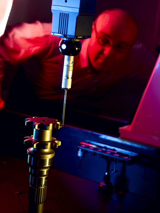

SP25 measuring the profile of critical featuresThe Renishaw SP25 is different from the original Renishaw touch trigger probes such as TP2 and TP6, fitted to thousands of CMMs worldwide.  It is a miniature 3 axis machine in its own right, capable of measuring the deflection of the stylus tip in any 3D direction.
The CMM is programmed to drive the stylus tip of the probe across the surface of the part, maintaining a constant probe deflection normal to the surface. If this deflection changes, the software adjusts the direction of travel to regain the constant deflection.  At the same time, data is gathered at a rate of up to 2000 points a second, both from the three axes of the probe and the three axes of the CMM.  This continuous stream of data would be impractical to gather using touch trigger probes.
The net result is that a large number of 3D points can be used to construct a 3D surface or profile in a matter of seconds, which when compared to a CAD surface or profile, immediately highlights any deviations.

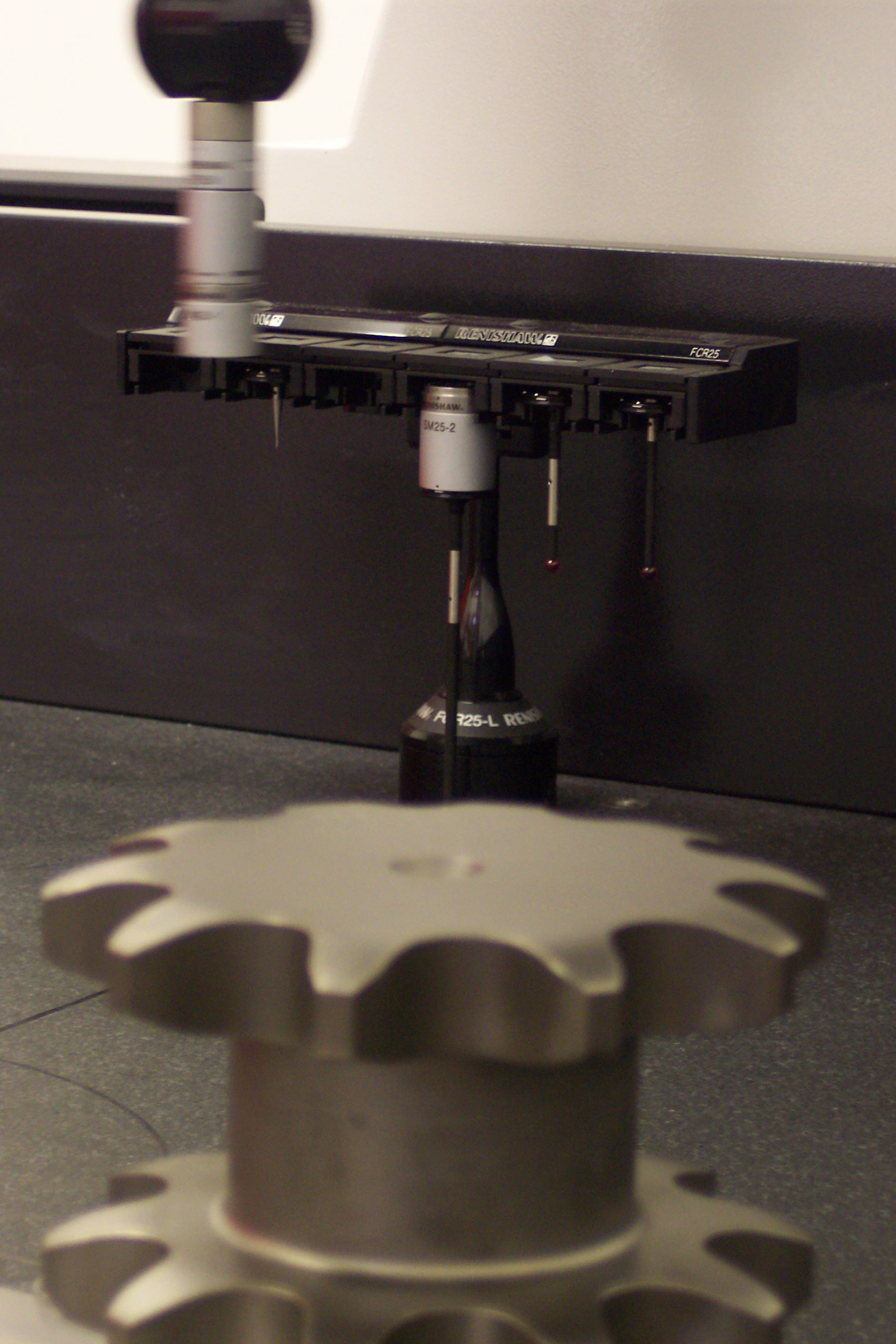

stylus changing function of SP25A key feature of the SP25 is the ability to change between different styli during an automated cycle, which MME uses during the measurement of a number of parts.  The different styli are mounted on modules with repeatable mounting joints, so that when the modules are attached to the probe body, the ball on the end of the stylus is back in the same position to within a fraction of a micron of the position in the which the ball was calibrated.
Modules are changed several times during certain inspection cycles, so that, for example, a longer stylus can be used to access the lower teeth of a double gear, or a smaller ball used to measure a small diameter hole.  The time to change between modules is a matter of seconds using the automated change rack.
