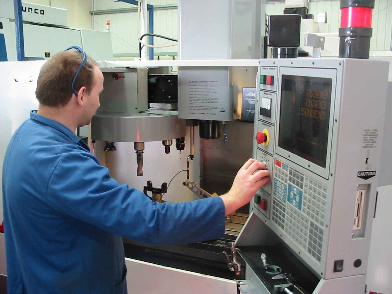

Haas case study imageHAAS Automation Inc. used to fine-tune every one of its VF vertical machining centres through a mechanical fore-and-aft loading test, with results entered into the CNC as a compensation value.  Recently however, the company began to supplement this test with backlash compensation using Renishaw’s QC10 Ballbar System. By measuring position errors throughout a complete circle, the Ballbar isolates effects often missed by the mechanical test, including the influence of friction, and problems in the motor/ballscrew connection.

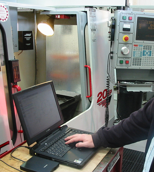

Haas manufacturing case study image - ballbarHAAS supplies a Ballbar circularity test plot with each new VMC shipped. Unique to the individual machine, the plot shows the trace of a 300 mm diameter circle in the X-Y plane, made at 25 or 50 ipm, depending on machine size. Through the precise match between an ideal circle and the Ballbar map of the machine’s true movement, the customer sees graphic proof of the contouring accuracy of the machine.
The test is frequently re-performed by HAAS UK once the machine is installed at a customers’ premises. Andrew Ward, HAAS UK Engineering Director commented: “The Ballbar check is a straightforward test. We are happy to show the customer that his machine is just as accurate after it has travelled the 6,000 miles from California”. He added. “We have also found the Renishaw Ballbar System invaluable as a diagnostic tool, if and when a problem does occur”.

The other tool used throughout the development and manufacturing cycle of every HAAS machine is Renishaw’s ML10 Laser Calibration System. “Laser and Ballbar inspection begins with new machine prototypes,” says HAAS Inc.’s Service Manager, John Roth. “When an error is found in a prototype, the problem is traced back to the machine that produced it.” He cites the company’s new VF-6 vertical machining centre as an example.
Roth used the Ballbar to test the multi-axis movement of the VF-6 prototype in all three planes, X-Y, Y-Z and X-Z. This was followed by straightness and displacement measurements taken using the laser.
