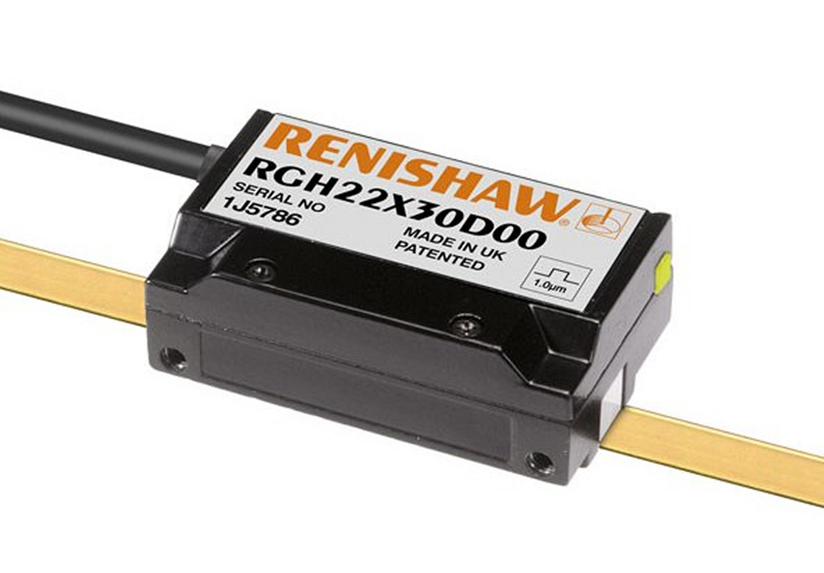

Linear encoder systemSixteen print heads, carried on a cross beam, traverse the entire surface area to be printed. Absolute geometrical alignment of the moving table and crosshead, and precise positional accuracy of the print heads, are guaranteed to within microns. The motion control feed back to achieve this is provided by Renishaw RG2 linear encoders, important because even tiny errors in print head motion would result in banded images or ‘out of focus’ effects that are easily visible to the naked eye.

The ML10 system, used at Inca, has a helium neon laser source that in conjunction with the EC10 environmental compensation unit, can offer linear accuracy down to +/-0.7 ppm. This unit has the capability to feed in certain environmental data, enabling material temperature, ambient temperature and relative humidity adjustments to be incorporated in the compensation program for an individual machine’s control system. This real-time compensation ensures that accuracy is consistent across the full environmental range.
