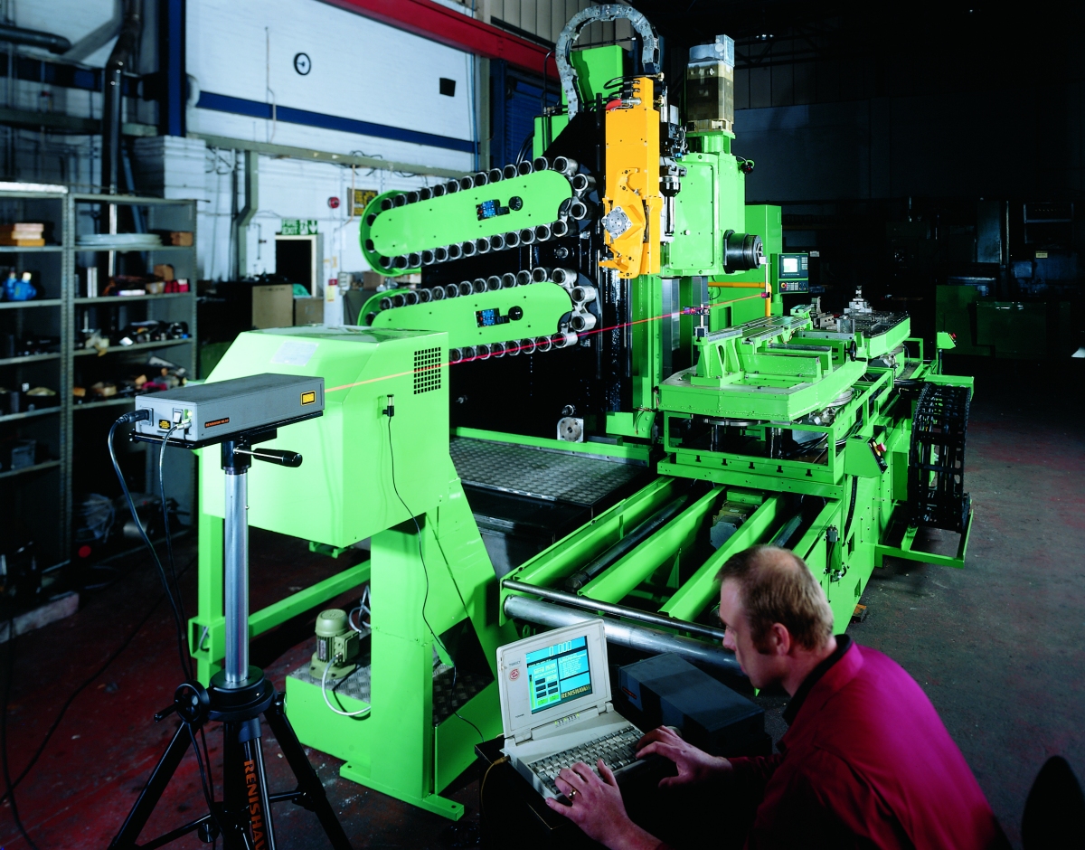

After producing axles for nearly a decade and having questioned the ability to maintain the machine, Dana Spicer - having once again considered new products, which still proved very costly - decided to have the machine re-manufactured by Murrall & Lang for a second time. Having experienced the benefits of Renishaw’s QC10 ballbar systems in the 1990’s, Murrall & Lang had no hesitation in utilising this technology and purchasing Renishaw’s ML10 laser calibration system to aid the re-manufacture ‘as new’, of the Cincinatti HMC for a second time.
Partner, Bob Murrall explained. “We had successfully produced a machine to Dana Spicer’s tolerance specifications in 1990 using a second-hand Hewlett Packard (HP) calibration system from a leading supplier. Today, that equipment is neither cost-effective nor comparable to the technological capabilities of the Renishaw systems.”
“It was our experience of the QC10 ballbar system, that led us to invest in the ML10 laser calibration equipment,” added Mr Murrall. “The ballbar is so reliable, it automatically identifies, quantifies and prioritises machine tool errors.  In seeing it used here, many of our customers, including Dana Spicer, have subsequently invested in the technology.”
Complete rebuild
The Y2K re-manufacturing process included a complete mechanical rebuild, with all worn parts being reconditioned or replaced, a complete rewiring, the fitting of new digital axis and spindle drives, and a new Siemens 840D CNC control. The process took less than six months and fully met customer specification. To improve reliability, the customer wanted to maintain accuracy by axis calibration and compensation.  This required the use of the Renishaw laser calibration system; part of Murrall & Lang’s quality control system.
“When you are re-manufacturing a machine, your alignments should be well within achievable levels of adjustment, allowing the alignments set by the original manufacturer to be achieved. In fact, the QC10 ballbar and ML10 laser system allow us to achieve tighter tolerances than was possible when the machine was first manufactured.  Whatever we attain here, we can reproduce at the customers’ premises.  The Renishaw ML10 laser calibration system is portable, easy to use and has built-in temperature compensation, allowing our customers to machine components far more accurately than once possible,” continued Mr Murrall.
