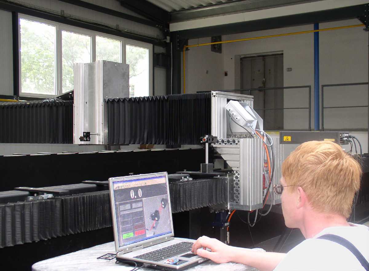

ML10 calibrating PTV machine

This is where the Renishaw ML10 laser interferometer measurement system and Laser10 software proves its worth. The system’s laser optics are mounted onto the structure of the finished machine and readings taken at every 20 mm of axis movement. This is compared to the value provided by the machine’s rotary encoder, which is at least always repeatable, to generate a compensation value for that specific position.
The positioning uncertainty on the original design could be up to 0.2 mm per metre. Jan Kunert now knows that accuracy is always better than 0.05 mm per metre and provides customers with a certificate from Renishaw’s Laser10 software to prove it.

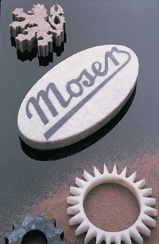

PTV - typical partsIn addition to the compensation provided by the ML10 laser interferometer for linear positioning, there are a series of other machine characteristics which PTV checks and adjusts through the use of a ten-minute test with a Renishaw QC10 ballbar.
