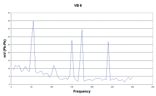

In comparison to previous systems the initial results from the VB300 show a marked improvement in the noise related error contribution. To clarify the improvement since the introduction of the RLE20, Vistec have undertaken “beam on edge” measurements where the electron beam is parked on the edge of a metal mark and the variation in the intensity of the back-scatteredVB300 noise spectra electrons is measured. This technique is used as it provides a measurement of the total noise in the system; mechanical and electrical, both on the beam and on the video system monitoring the back scattered electrons.
Comparing the VB300 spectra to that taken from the VB6 tool it can be seen that the VB300 shows no evidence of the peak at
175 Hz, the identified feature that Vistec wanted to remove. Additionally the peak at 240 Hz had been removed and the 150 Hz feature reduced.VB6 noise spectra
Tingay states: “Noise measurements from the VB300 are very good, no mechanical vibrations can be seen, I expect the total noise to be about 2 nm – 3 nm with no observed contribution from the reference mirror or interferometry system.”
