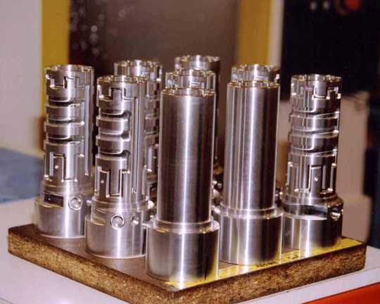

With a basic product range extending from large, ‘slow-speed’ spindles and powerful motorised units (1 kW and 80,000 rpm) up to small ultra high-speed (250,000 rpm) spindles, manufacturing flexibility is clearly important.  Components to be machined, the majority of which are cylindrical in form, vary in size from as little as 5 mm diameter up to 85 mm diameter and from 3 mm to 235 mm in length. They come in a variety of materials, including aluminium, stainless steel and bronze.

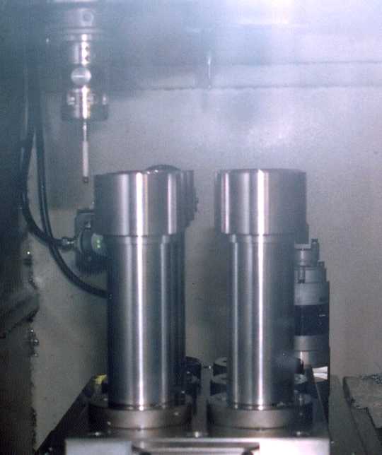

OMP40 spindle mounted probeJohn Read, ABL’s workshop supervisor, says: “We recently introduced various Renishaw probing systems on a number of our machine tools as part of a cost reduction exercise aimed at reducing set-up times.
We found that they could also enable us to introduce multi-load fixtures, instead of using single loading, because they can create and store datum positions on several components. By probing each component on such multi-load fixtures, our policy of continuous quality improvement has been maintained.”
Small as well as large batch production

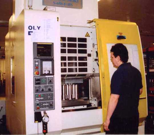

Renishaw’s OMP40 spindle probe and the TS27R tool setting system are installed on each of four of ABL’s Fanuc Robodrills. They are also used on a Haas VF1 vertical machining centre, a machine with four-axis capability that handles a high volume of work with a minimum number of operations. OMP40 probes are also used on two of ABL’s Olympic Seiki vertical twin-pallet machines, together with Renishaw TS32S tool setting systems.
The TS27R is a highly flexible, cost effective tool-setting probe for vertical applications. Its compact and robust design allows simple fitting to the machine bed and can be used to set tool lengths in Z and rotating tools in X and Y, for radius offsets. The Renishaw TS32S, with infrared transmission of the probe signal, is used on the Olympic Seiki verticals because these machines utilise twin pallet load/unload systems which would not allow hard-wired systems.
The OMP40 spindle-mounted probes have proved to be perfectly suited to the small machines. They are primarily used running on a batch production basis for component referencing and inspection tasks.

Air Bearings maching centreSays ABL’s managing director, Mr Kelly Henocq: “Currently, many of our completed spindle assemblies are destined for installation into special-purpose machines designed to drill printed circuit boards. These ‘state-of-the-art’ production units require the spindles to operate at speeds as high as 300,000 rpm, as well as demanding extremely high dimensional accuracy (with drill run-out to less than 5 microns) throughout the entire speed range”.
