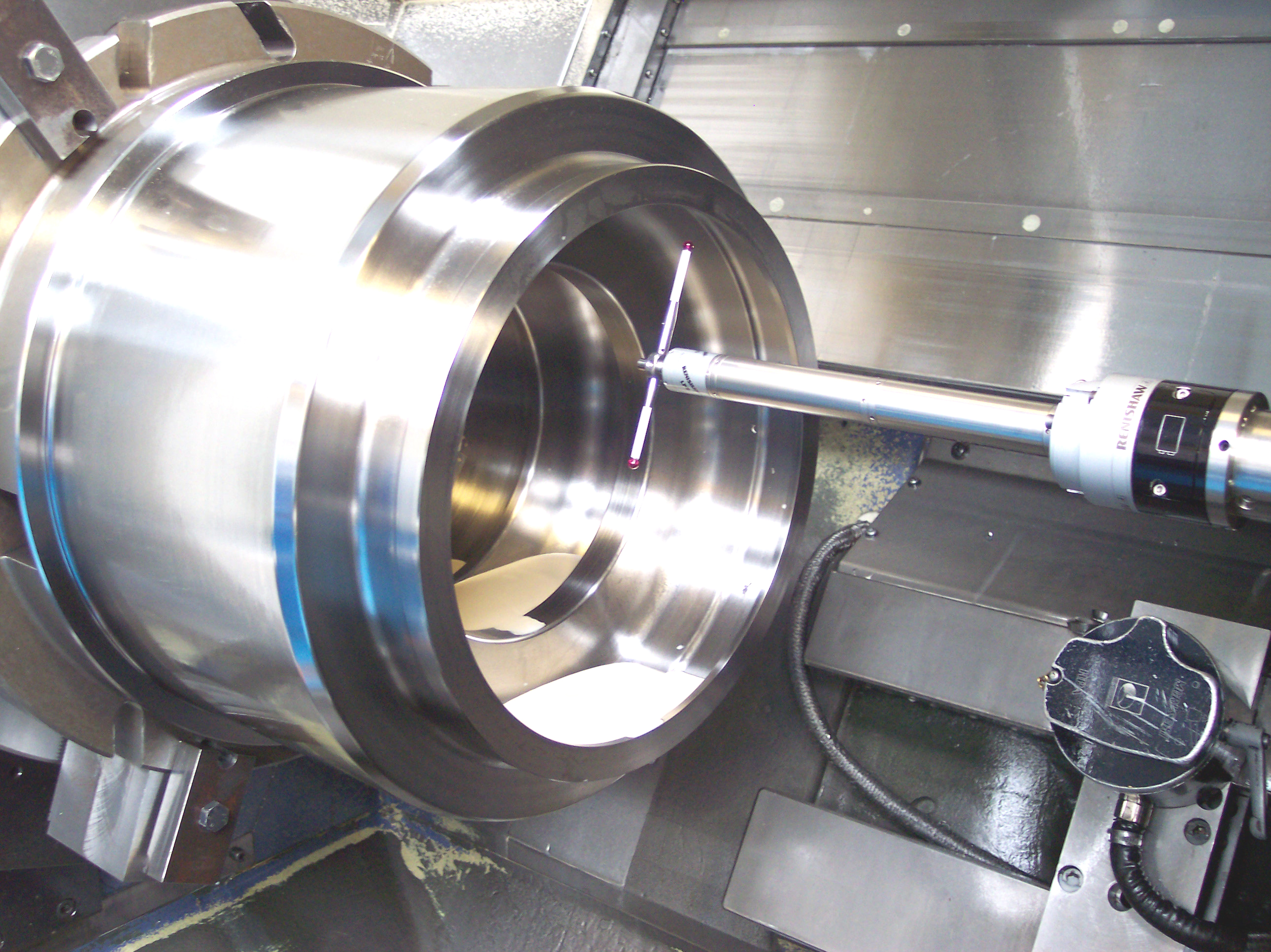

Turret probingThe directors of Castle Precision have embraced the latest technology in every discipline, but not for the sake of it – this is technology applied so effectively that in some cases ‘wasteful’ operations have been reduced by over 80%.  As an example, Renishaw probe systems on Castle’s CNC lathes have reduced inspection times from about 35 minutes to less then 6 minutes.

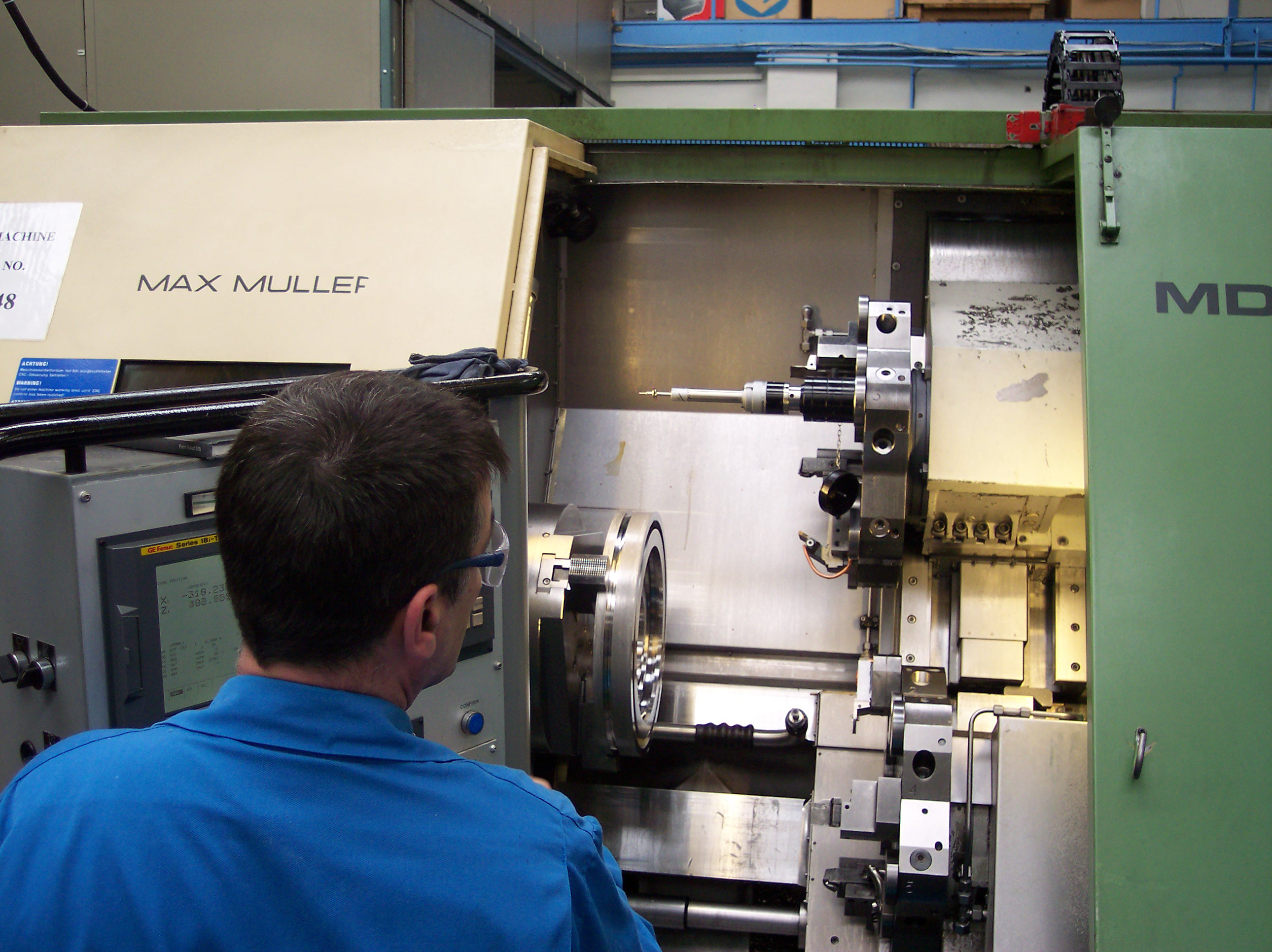

Turret probing and removable tool setting armSpindle probing is well accepted on machining centres but Castle have also demonstrated how effectively it can be used on CNC lathes for set-up and inspection tasks.  Director of Engineering Alex Skinner, who, together with Marcus Tiefenbrun, has provided the inspiration behind the drive for technology, explains why this process in particular demonstrates how efficiency gains can be made.
“On one component we used to spend 35 minutes on in-process inspection – this had to be improved.  It was manually loaded and had to stay in place, effectively part of the machining cycle, so the machine was stopped, not producing parts, for the whole of the in-cycle inspection.  The inspectors would measure a particular thin-walled feature, decide whether or not it met specifications, pass or fail the part, and then not even record the measurements they had taken!  We replaced this with a probe cycle, reducing the inspection cycle to about 6 minutes.  The measurements taken are recorded in an SPC package and kept on record.  We can tell instantly the measured dimensions of every part we have made over the last 5 years!”
Intelligent decisions with probing systems
setting tool cutting tipsThat’s not the end of the story – Alex Skinner continues “We decided to use the probe to make intelligent decisions.  The measurements the probe takes are used to update offsets, these offset changes are downloaded and recorded to monitor and control the process.  We have been able to significantly reduce human intervention, such that now each operator often runs two machines instead of one.”

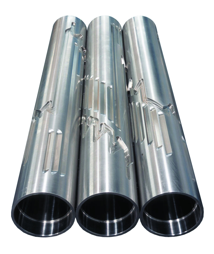

Quality and tight control are essential because our business is mostly ‘high-end’; we don’t usually get involved with low-cost parts.  We have learnt to specialise, for example in titanium parts for a whole variety of industries, and not even attempt to compete on mundane parts with developing countries.”

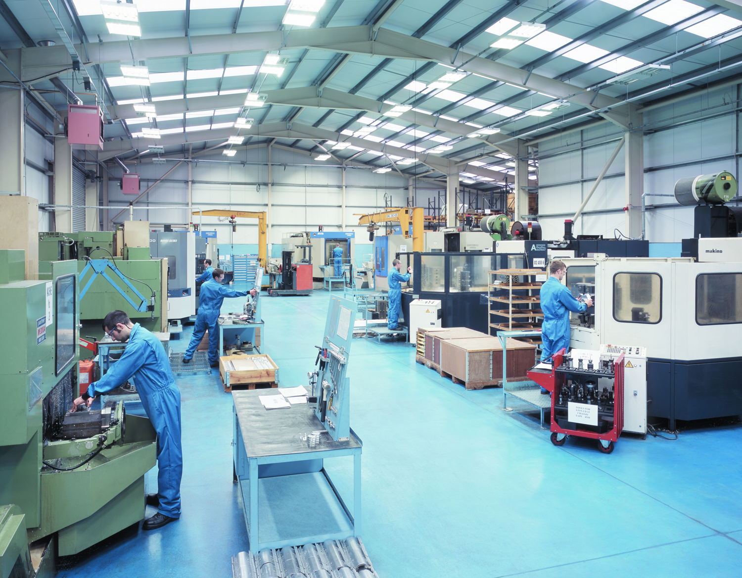

Castle Precision production scheduleCastle’s computer system has to be seen to be believed!  ‘System’ is the correct word to use, because every company application is integrated into one program.  This system can be accessed live from any other terminal (of which there are many dotted around the company) by a real-time biometric fingerprint recognition system.  Employees have access to the information they require from the system, which includes CAD/CAM functions, production scheduling, time recording, inspection reports, invoicing, sales databases, even personnel records!
