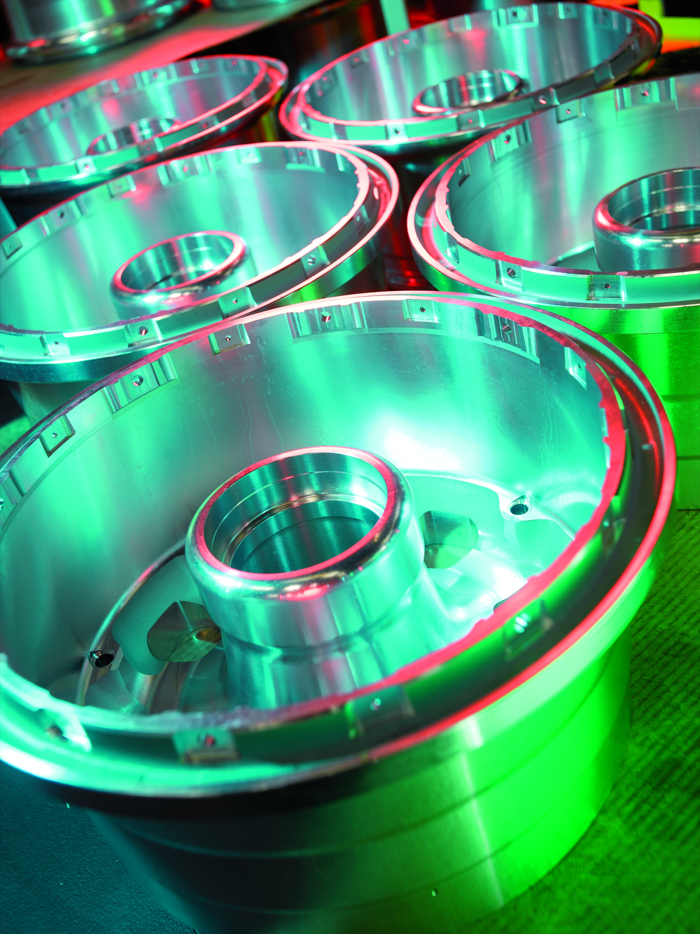

Runners, repeaters and one-offs
Wheels for the Gulfstream G500/G650Orders for wheels fall into three different categories according to the number of batches made each year. The 'runner' orders are classed as those wheels produced in more than 10 batches a year; 'repeaters' are less than 10 batches a year. Dunlop Aerospace also supply one-off orders and recently succeeded in a very impressive project to re-manufacture components for the 1950s Canberra. This involved taking original drawings and re-programming the machining through the modern CNC process.
Mr Cartledge continues, "NPI involves a process we call Manufacturing Process Approval (MPA) whereby any machining process must be closely analysed to see if it affects the stresses and component strengths of a wheel assembly. All the main ‘runners’ and any ‘repeaters' that are introduced to the new cell need MPA before production can start."

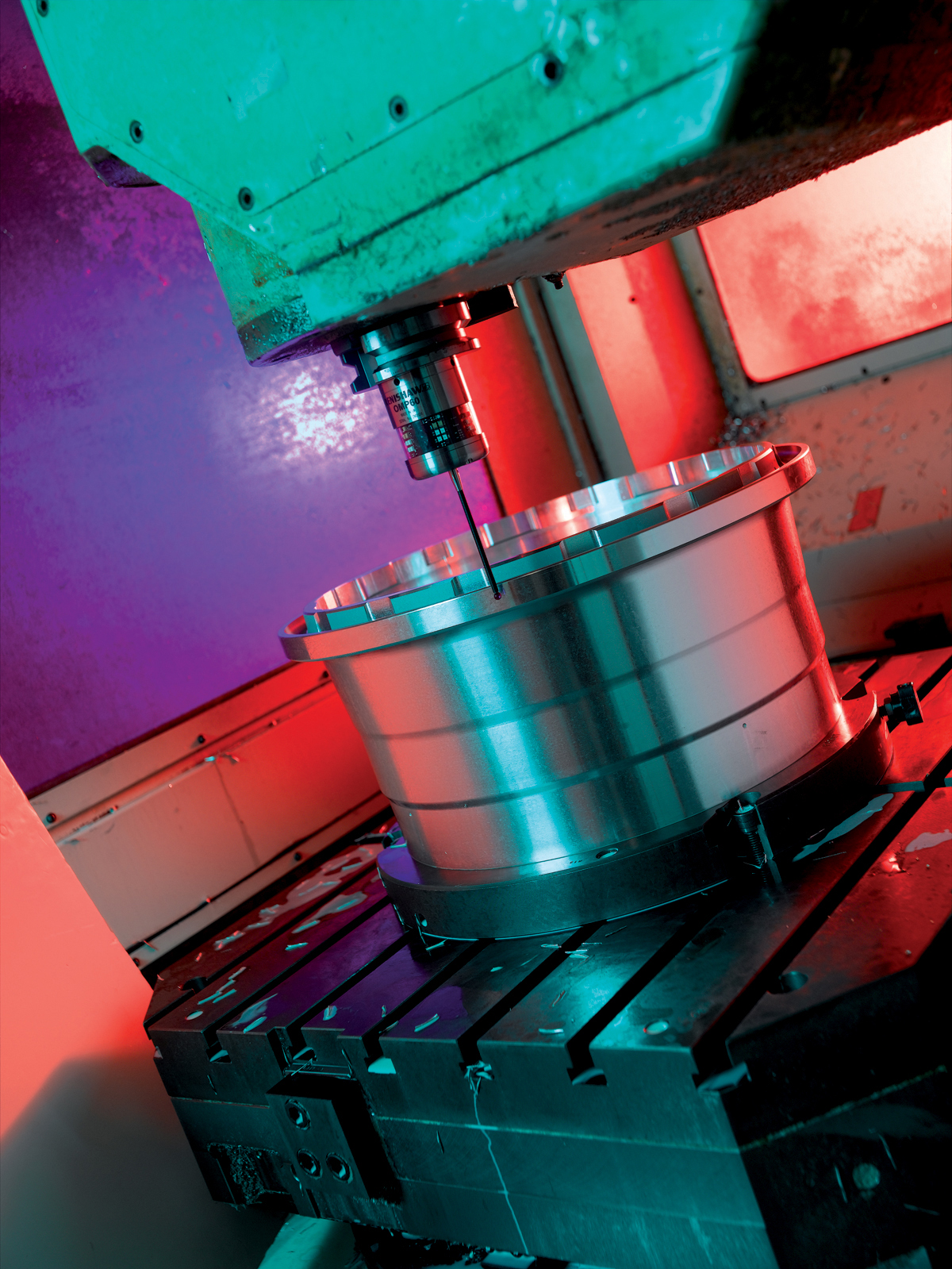

Between 1998 and 2000 Dunlop Aerospace chose to spend nearly £2 million on three state of the art multi-axis CNC machines; a multi-axis Mazak Integrex - a turning centre with full C-axis and driven tooling to give milling capability; a Mazak HV800 5-axis horizontal machine centre; and the most recent investment, a Mori-Seiki MT4000, at the time the first of its type in the UK.
Probe systems make all the difference

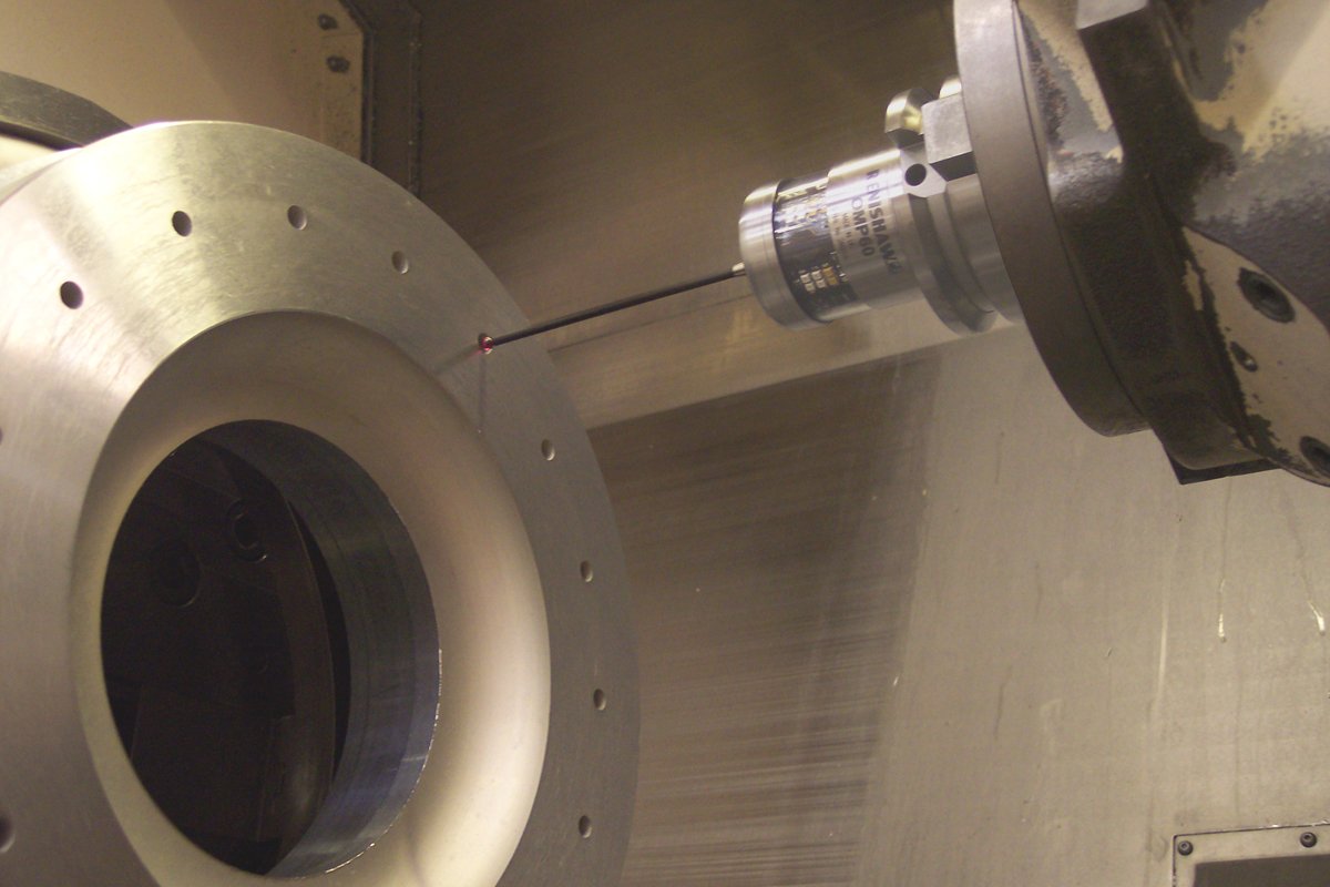

Dunlop Aerospace - Turboprop passenger planeThe underlying technique made possible by the integration of the probe systems is the ability to identify the component position and material condition, updating and monitoring the deviation in the wheel forgings. This reduces cutting time, as it eliminates fresh-air cuts - this is because the probe ensures that the critical surfaces of forgings are accurately located and metal cutting starts immediately.
The importance of one hit machining
Dunlop aerospace OMP60 on Mazak IntegrexDuring the cutting process stresses are relieved in the material, so one hit machining results in the cutting process achieving greater consistency. L77 aluminium is the most commonly used material and, with the high cost of each process, it is essential that Dunlop Aerospace keep scrap levels low. In-process monitoring and tool offset updating ensures process control and minimises scrap.
