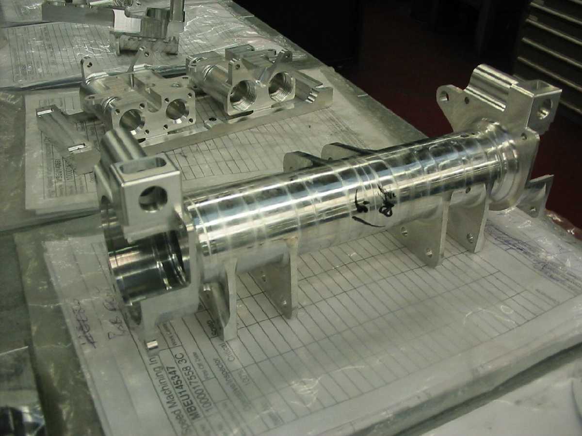

Typical complex componentsThe complex machined components that go into the seats have multiple features, and demand very high standards of quality control to ensure reliable operation in the toughest conditions.  Aluminium is the most common material, and with the machine time and resources almost all finished parts are of a high value, so minimising scrap is of paramount importance.

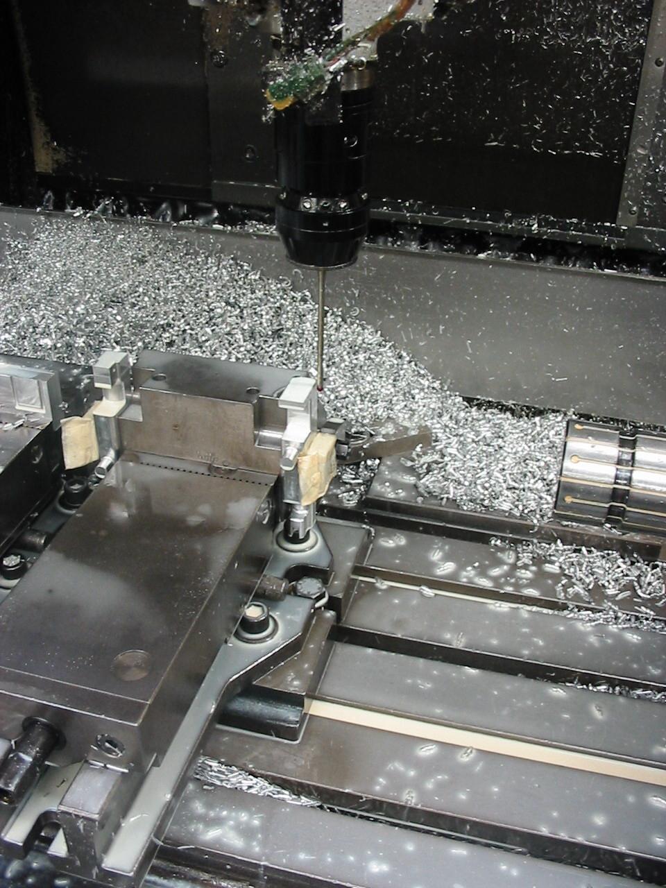

MP10 spindle probeWhen a pallet is loaded into the machine containing the raw material on simple fixtures, the first feature is machined and immediately probed with the Renishaw MP10 probe.  This measurement establishes the datum to which all subsequent machining is related - the programs do not rely on the accuracy of the fixtures.  Peter Smith, the production engineer and programmer responsible, adds, “the probe is also used when needed during the course of the program, probing the machined surfaces then machining the next ops relative.  This guarantees positions on bores and other features that must relate to each other rately.  All components are probed at the end of machining, which allows the machine automatically to make ‘intelligent’ decisions such as whether extra ops are needed.”
“When needed” is a key phrase here, the probe system being sufficiently flexible to be used only when a measurement is required, with routines lasting just a matter of seconds.  The programmers need add only 1 or 2 simple lines of code to their program to take these measurements, with the resident probing software enabling the probe to be loaded into the spindle from the tool changer, working out the necessary moves and automatically updating offsets.

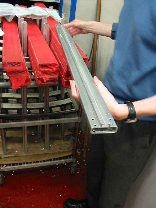

Ejection seat guide railsProbes have also found applications on three Makino 106 CNC milling machines, each twenty years old but still in full production and expected to hold consistent tolerances on key components.  The probes are used for job set-up in several different ways, for example, forged billets are clamped into the vice and the probe checks certain features to detect any variation in the forging.  The readings can be used by the machine’s control to ‘decide’ where machining starts and how many cuts are required, eliminating ‘fresh-air’ cuts and any scrap due to setting.
These Makino machines are also used to produce the slots on the guide rails along which the seat will be propelled when used.  While the weight must be kept to a minimum, it is essential for the strength of the rail that the wall thickness is sufficient along the full length.  This brings challenges when setting up and aligning.  The probe checks the exact position of multiple positions on the material clamped to the machine bed.  These readings are used to adjust the machining program and ensure that the correct amount is machined in all the required places. Before probing, when this was done manually, the whole job took over 2 hours.  Each rail is now completed in 30 minutes, with a far higher confidence and reduced scrap.
