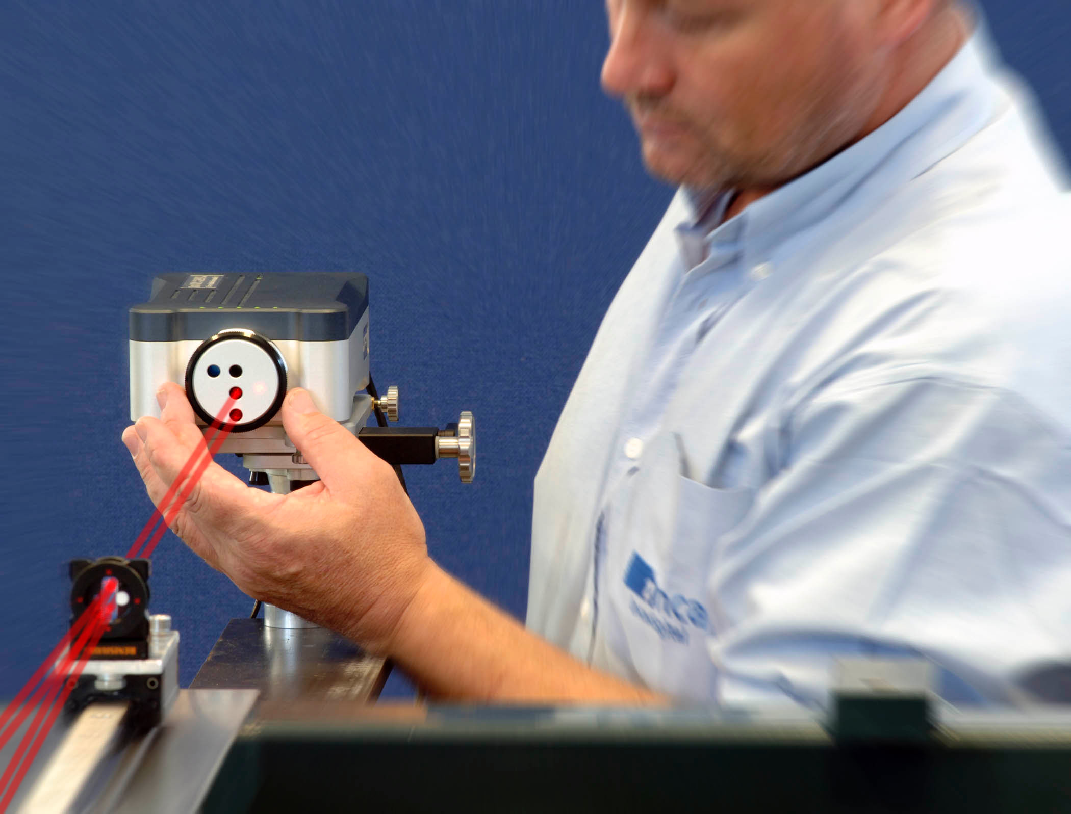

Person next to inca machine“Today’s printing companies want a combination of speed, quality and repeatability,” says Inca’s Director of Technology, Dr. Will Eve. “They also want print at large sizes, which makes the other three more difficult to attain. To help us achieve all four, we check all of our printers with a Renishaw XL-80 laser.”

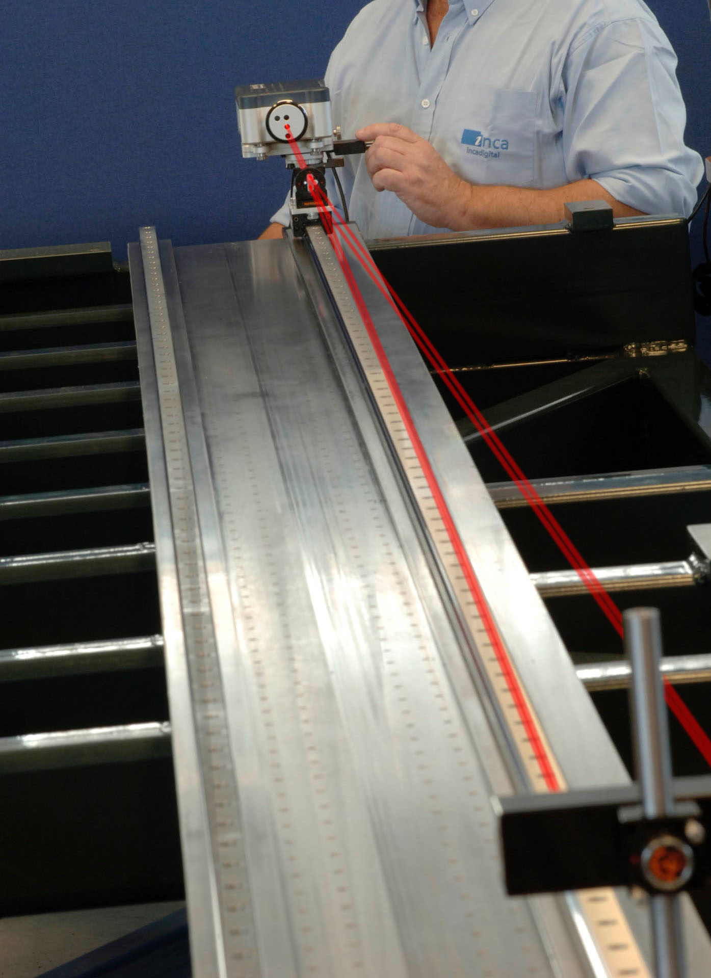

Inca - xl-80“We use the XL-80 for both static and dynamic measurements,” says Dr. Eve. “When we’re building our machines, we take measurements along the length of the main rails - some of them up to 11.5m - to make sure the chassis is aligned when it arrives from the fabricator. Then, when the machine is built, powered up and tested, we use the Renishaw XL-80 to measure the accuracy and repeatability of the moving machine. Although our previous ML10 laser was excellent for up to 1 m/s measurements it could not measure at the machine’s full speed. With the high speed measuring performance of 4 m/s of the new XL-80 we can now discover any positioning errors and store the error values in a file in the machine’s control system. This then uses the values as the basis for its dynamic compensation. So we know the printer head will always move as intended.”
