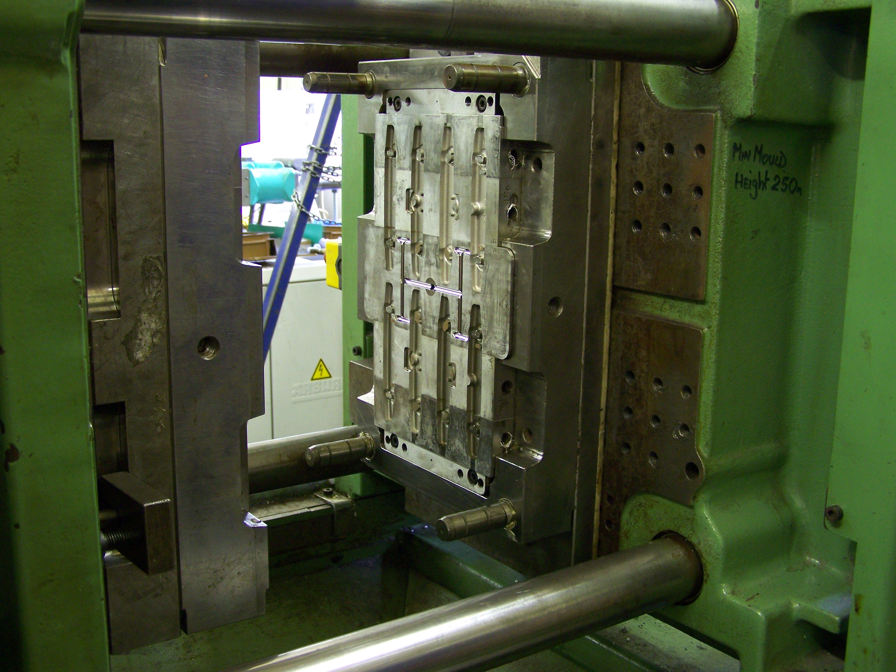

The mould tools to produce Aquapac plastic mouldings are multi-part complex machinings that can be taken apart and re-assembled to produce different sizes of clamp.  These parts must go together perfectly; a gap of 20 – 30 μm would result in plastic flowing to the wrong places.

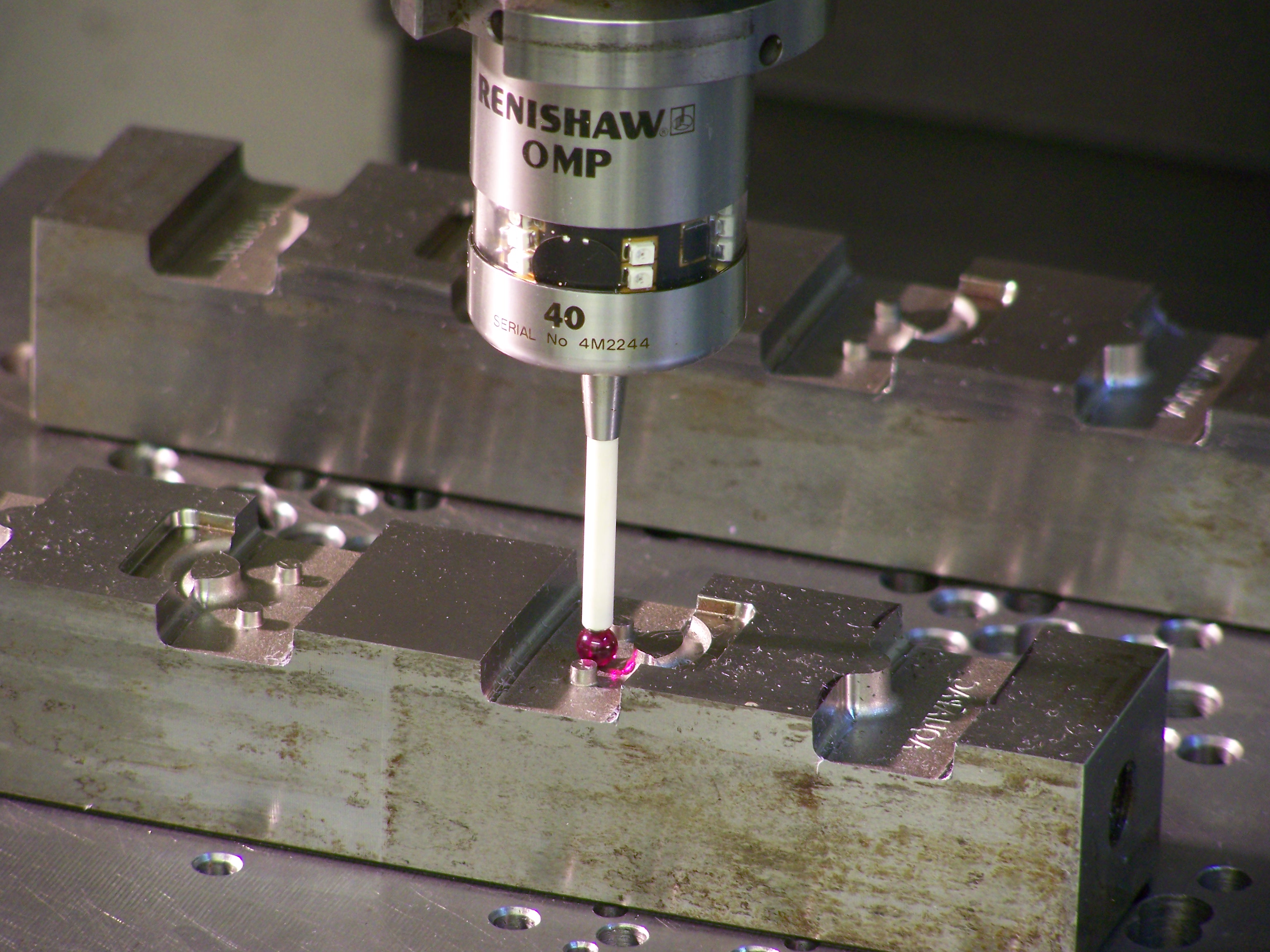

B K Tooling part setting“Probing is the only way to achieve better than 10 μm repeatability which cannot be done by craftsmen with hand-tools afterwards” explains Mr Tunks.  Initially the metal billet is set on the machining centre using the spindle-mounted probe, then first machining operations are completed, but this is not the end of the story.  The billet then has to be removed, rotated and re-set to be perfectly positioned relative to the first machined features, ready for spark erosion.  This is where probing proves critical.
Combining good fixturing and probing

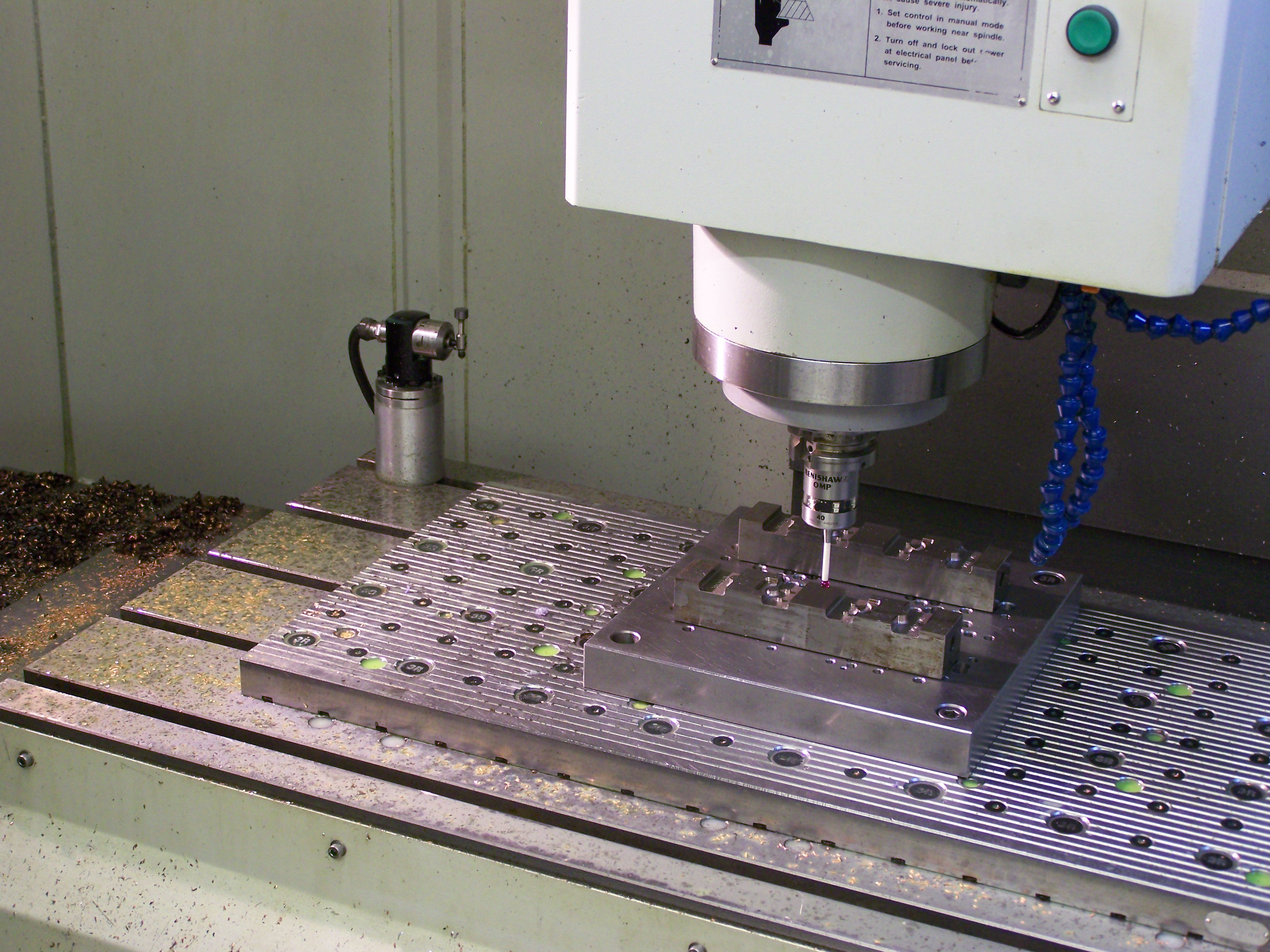

Mr Tunks explains “The fixturing is very good but the reality is that you have to cope with thermal errors and clamping forces as well.”  A 3R fixturing system is used, which re-positions fixture plates to within 5 μm, but the other factors mean that a rapid probing operation, taking a matter of seconds, ensures machining will be within tolerance.

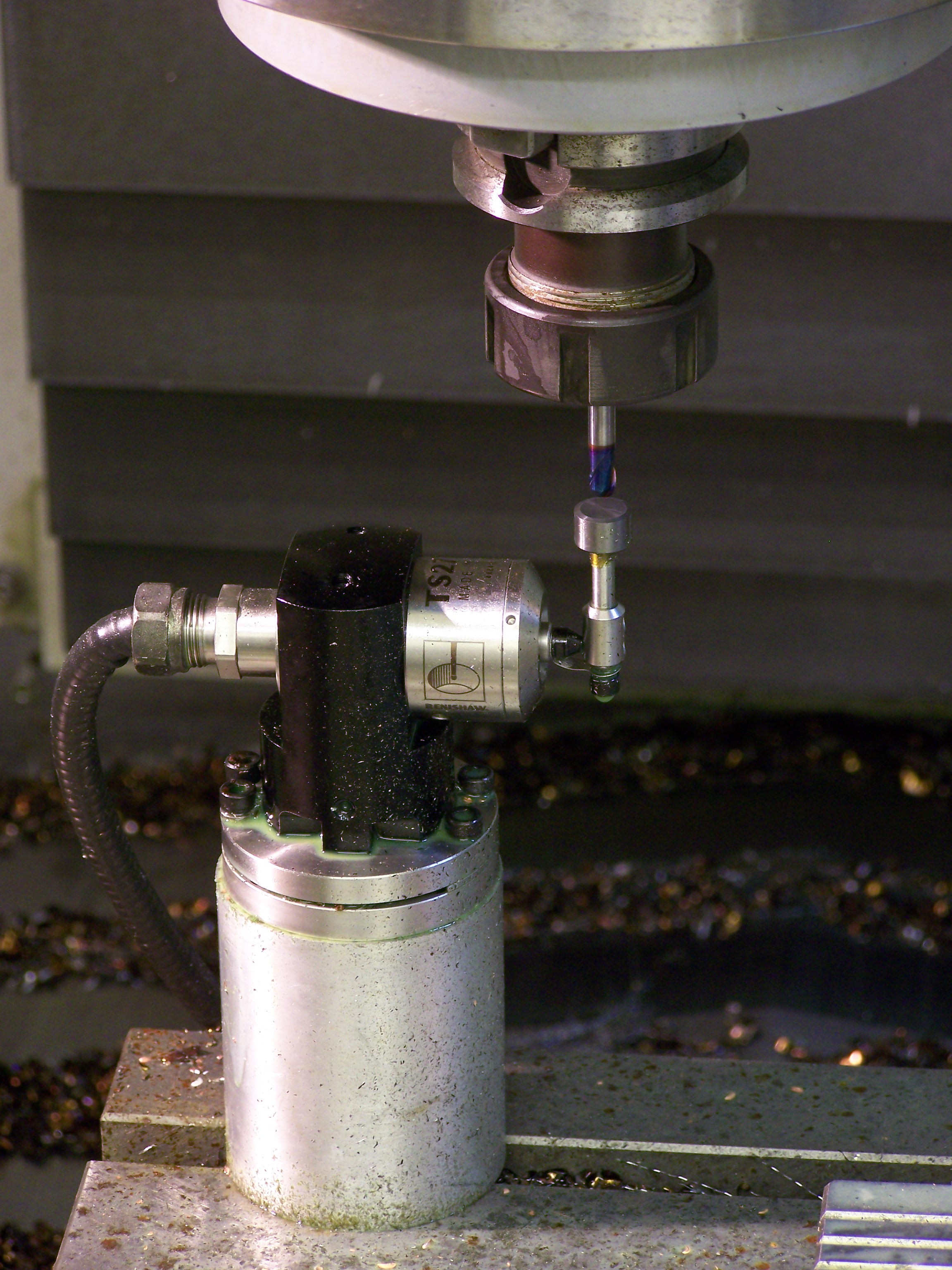

B K Tooling tool length settingThe XYZ machine also has a table-mounted TS27R tool setting probe fitted, which sets tool lengths for all the ball cutters used, at multiple diameters, down to the smallest at Ø0.4 mm.  All sizes must be checked for length, which is done on the machine rather than using a pre-setter, taking into account thermal effects such as spindle growth.
The range of cutting tools is limited to about 60 different cutters, with machining programs designed to use this library of tools.  Luckily, the machining of mould tools doesn’t require processes like drilling and tapping holes, making tooling selection more straightforward.
