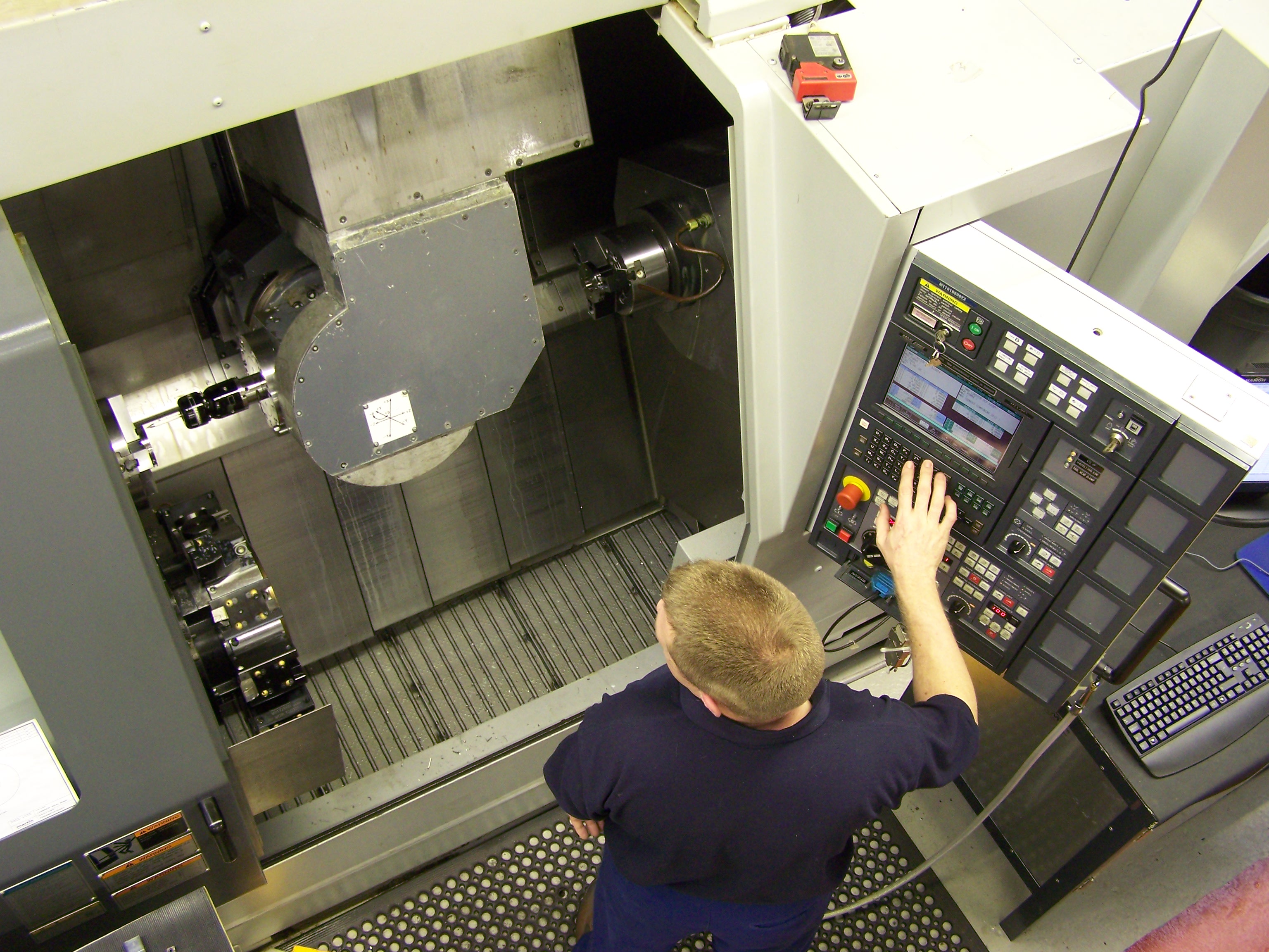

Martin Aerospace Mill-turn machineManufacturing the Rolls-Royce engine component, which features a complex geometry and very tight tolerances, could have proved very challenging.  It is made of Inconel, a material that has to be machined correctly the first time, not lending itself to re-work.  As Bernie Phimister comments, “This makes it vital that the machining process is controlled at source, rather than inspecting finished components and attempting to tweak the process afterwards.”
Renishaw looked at the original process and recommended a visit to Renishaw’s demonstration centre, after which Martin Aerospace had a high-accuracy MP700 touch probe fitted to the twin chuck mill-turn machine producing the part.  The probe is used to measure the finished size of several features, with the operator using the printed results to update machining offsets.
