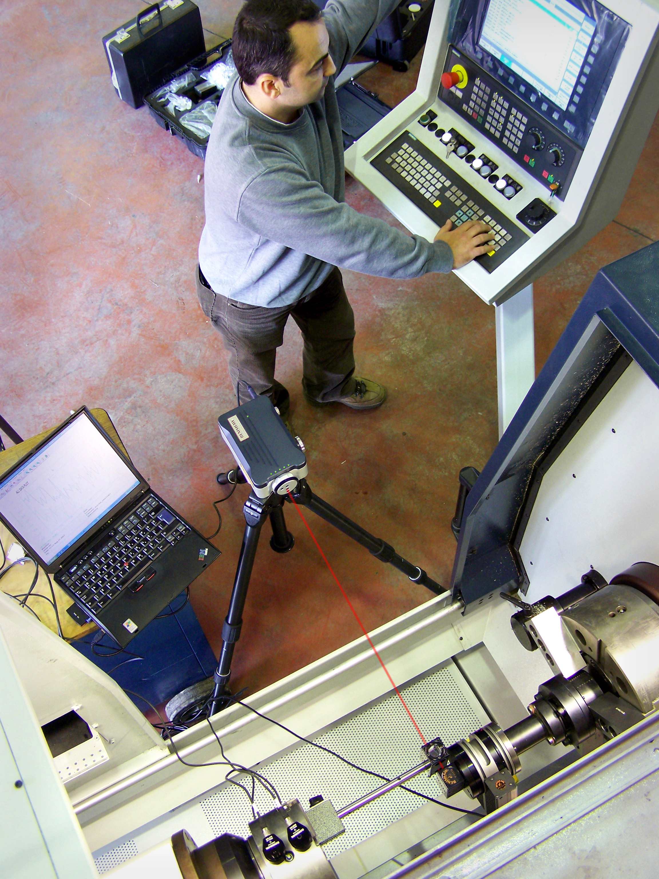

Spinner - XL-80 laserMr Nurhan explains one of the areas in which Spinner has seen most benefits from laser calibration, “We test and calibrate the rotary motion of every sub-spindle fitted to our turning centres because the encoder on the motor, although repeatable enough, does not position as well as we want.  Some encoders are only accurate to 6 arc minutes but by using the Renishaw RX10 rotary calibrator unit, we can guarantee better than 1 arc second repeatability.  This is done by testing the sub-spindle on the finished machine. Errors detected by the RX10 are corrected by adding compensation values generated by the RX10 software to registers in the  controller.  The sub-spindle is tested again to check the new positioning accuracy and provide a traceable calibration certificate, with options for formats according to various international standards.”
The RX10 is an accessory for Renishaw’s laser calibration systems, allowing the comparison of the programmed rotation of a drive or rotary table to the actual rotation as measured using a traceable Spinner - sub-spindle laser calibrationlaser source.  This is done by mounting the RX10 on the rotary axis, then programming the rotary axis to rotate in defined steps.  After each axis move, the RX10 unlocks, and rotates back to the previous position, re-locking on a highly repeatable Hirth coupling, accurate to 1 arc second.  Angular optics are mounted on the RX10 and any angular error compared to the previous starting position is recorded.  These error values are used for compensation.

Spinner - pump componentCurrently, one-in-five of Spinner’s CNC turning centres have their linear axes fully calibrated, in response to a customer’s request for higher accuracy machines.  On those machines that are not calibrated, the machine positioning is checked at only two positions, 0 and 300 mm, adding a single compensation value to the machine’s register and not taking into account anything in between.  Spinner turning centres can be supplied with three main axes, X, Y and Z, and also the moving axis for the sub-spindle.
Mr Nurhan explains the advantages of using the Renishaw laser calibration system, “Backlash can change along the length of the axis and repeatability is not consistent, so the step by step measurement we can perform with the laser is ideal.  We set the movement steps to 10 mm, the same as the ball screw pitch, to pick up on backlash at each point.  The tests are done before and after error compensation to see the difference.”  To prove machine capability to customers, Spinner delivers all tested machines with a calibration certificate, traceable to international standards.

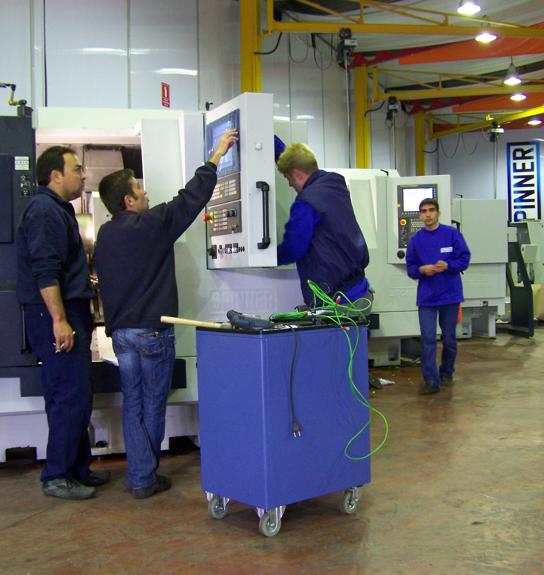

Spinner - ballbar with controlComplementing Spinner’s laser calibration system are two Renishaw QC10 ballbars which allow rapid tests of a machine’s positioning performance.  A single test, typically taking around 15 minutes, is all that is required, analysing 22 possible sources of error and producing reports to international standards, including  single figure indicators of overall performance (circularity and position deviation). Spinner uses the ballbars for two separate tests on every machine.
The first is at the factory, mainly to set up the machine control systems.  One aspect in particular that they can quickly sort out is axis synchronisation, ensuring that all axes during combination moves arrive at their destination at the same time. The second ballbar test is run when the machine is delivered to a customer’s site, this time to examine the mechanical and structural characteristics, helping to adjust and level the machine.  The ballbar test results show whether the axes are square to each other, giving exact values for any adjustment required.  This test is repeated after adjustment to give final proof that the machine is level.
