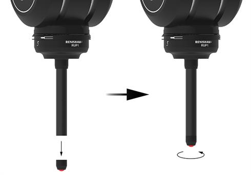

Assembling the elastomer balls into the end cap
1. Unscrew the end cap from the RUP1.

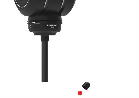

2. Remove the elastomer ball.

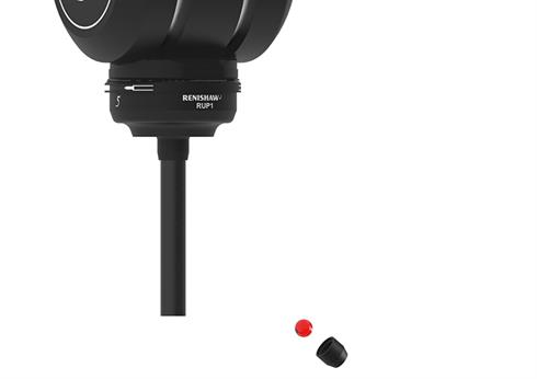

3. Open the bag containing the new elastomer ball. Without touching it tip the new ball in to the end cap.
4. Screw the end cap back on to the RUP1.
WARNING: Try not to touch the elastomer ball by hand.
