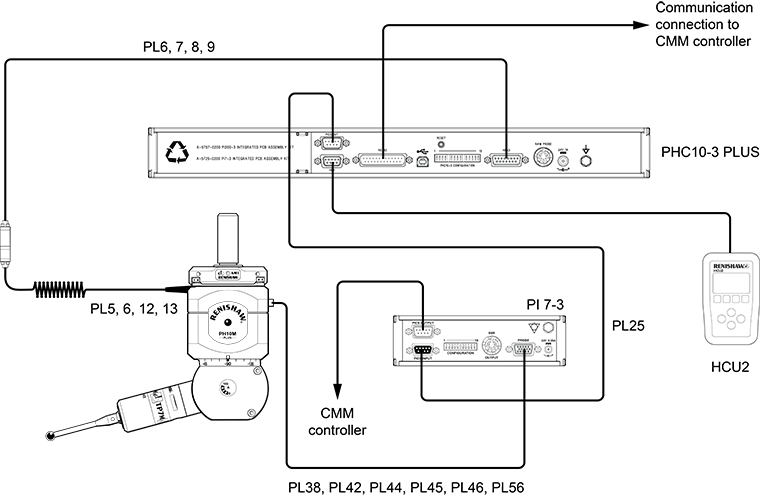

PICS can be incorporated in a range of systems of varying complexity. Four examples are shown in the following figures.
NOTE:
  • The order in which the elements of the system are connected is important
  • The system must have an external interface to operate correctly
  • If used, the motorised head controller should be furthest from the CMM controller
  • If used, the autochange system should be the closest to the CMM controller (except for installations containing a PI 800-2 interface)
  • All PICS connectors to Renishaw equipment are 9 way ‘D' type plugs and sockets
PHC10-3 PLUS and PI 200-3
PHC10-3 PLUS with PH10M PLUS, PH10T PLUS and PI 200-3
PHC10-3 PLUS and PI 200-3 with autochange
ACC2-3 with PH10M PLUS and TP20 or TP200
PHC10-3 PLUS and PI 7-3
PHC10-3 PLUS with PH10M PLUS and TP7
PHC10-3 PLUS and PI 7-3 with autochange
ACC2-3 with PH10M PLUS and TP7
