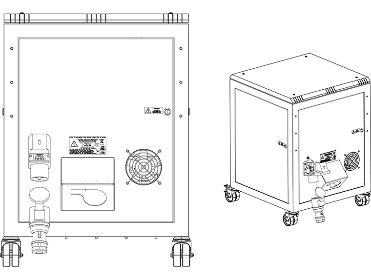

Retrofit cabinet specifications
WidthDepthHeightWeight
600 mm
600 mm
725 mm
(826 mm including castors)
Empty: 47 kg
Fully equipped: Approximately 80 kg (depending on equipment used)
Retrofit cabinet - dimensions
NOTE:
The maximum load of the castors is 80 kg.
Retrofit cabinet connections
C14 input connection
Retrofit cabinet - input connections - C14
CMM cabinet typeInput connectionElectrical ratingsCertifications
A-5567-1000C14 - IEC flange fused inlet250 Vac @ 10 ACSA 1425684, UL E92187, VDE 886700-1550-0716
A-5785-0100C14 - IEC flange fused inlet250 Vac @ 10 ACSA 1425684, UL E92187, VDE 886700-1550-0716
CEE industrial socket input
Retrofit cabinet - input connections - CEE
A-5785-02003P CEE industrial socket110 Vac @ 16 AIEC 60309-1 and IEC 60309-2
Output connections
Retrofit cabinet - output connections
CMM cabinet typeOutput connectionElectrical ratingsCertifications
All cabinetsIEC type F 6-way × 2250 Vac @ 10 AUL94V-0, IEC60320-1, UL498, CSA C22.2
