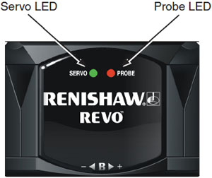

The head incorporates two LEDs for status indication in various modes.
LED status | Servo LED | Probe LED |
Off | No power (probe LED also off) | Probe trigger |
Green | Servos on | Probe calibrated |
Red | Servos off | Stylus removed (or probe error) |
Red flash | Comms to head failed (probe LED also off) | Probe removed from head |
Amber | 'Soft engage' mode | Probe turned off |
Amber flash | Auto-tune in progress | Probe not calibrated |
