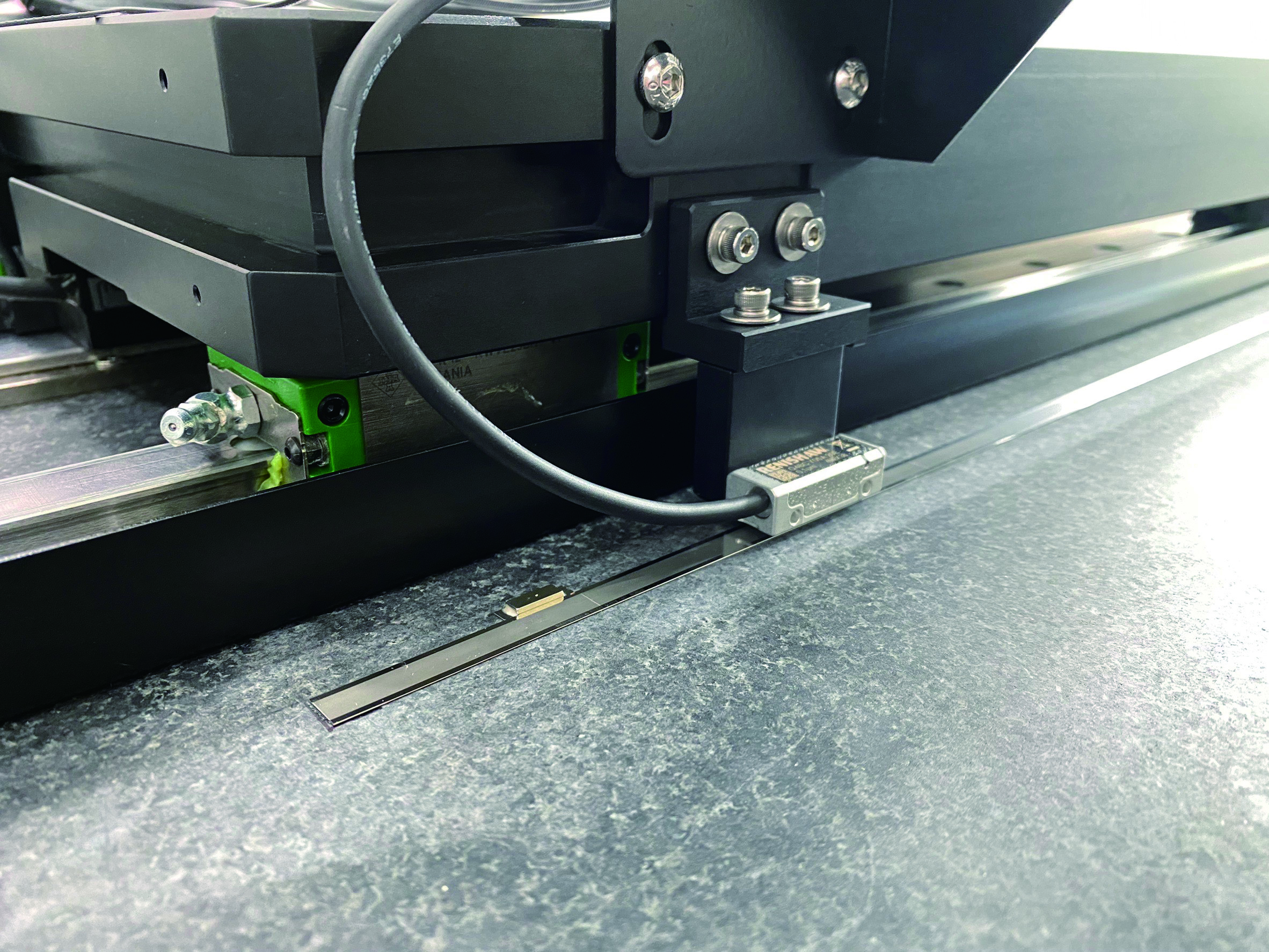

However, precise position feedback still relies on optical encoders. Taking one of TOYO's high-performance air bearing gantry stages as an example, it uses RESOLUTE™ absolute optical encoders with RELA ZeroMet™ low expansion scales.
The stage's repeatability is better than 1 μm, the crossbeam's yaw angle is less than 3 arc seconds, the maximum speed is up to 1 m/s, and the X and Y axis travels are 350 mm and 1200 mm, respectively.
The RESOLUTE encoder features 50 nm resolution and is connected to the controller via the BiSS C communication protocol. This stage has low velocity ripple, making it suitable for applications that require high-speed and stable movement, such as PCB printing or direct imaging (DI) exposure machines.

VIONiC installed at ToyoVIONiC optical encoder installed on TOYO machine

Temperature – temperature changes can cause thermal expansion and contraction of the optical encoder scale, affecting its accuracy, especially when micron or even nanometre-level positioning accuracy is required. Therefore, air bearing stages mostly use materials that are not sensitive to temperature changes, such as granite substrates and Invar® scales with a thermal expansion coefficient close to zero.
Sub-Divisional Error (SDE) – Sub-Divisional Error directly affects the smoothness of the axis motion, and low SDE also reduces velocity ripple. AOI inspection and printing applications, for example, require low SDE. Renishaw RESOLUTE and VIONiC encoders have SDE values less than 30 nm and 10 nm respectively, which can meet most requirements.
Jitter – all encoders have inherent uncertainties associated with internal electronics and jitter is the measure of this uncertainty which is seen as positional noise output by the encoder when it is not moving. This can contribute to motion stability of the stage when trying to hold a fixed position. The jitter of VIONiC encoders is only 1.6 nm RMS, making it suitable for applications where position stability is critical.
