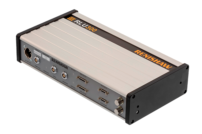

Each RLE system consists of an RLU laser unit with one or two detector heads, connected by optical fibres and data cables. The RLU laser units feature enhanced frequency stability and reduced positional noise.

The RLU100, RLU200 and RLU300 laser units include precision electronic and opto-mechanical assemblies to provide accurate position feedback for next-generation motion systems.

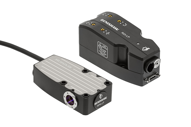

A range of differential interferometry (DI) and plane mirror interferometry (PMI) detector heads provide accurate position measurement to meet the requirements of motion control applications.

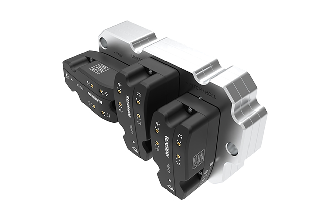

Our accessories support accurate installation, alignment, and measurement helping to optimise performance and improve usability. They also enable multi-axis configurations and multiple degrees of freedom measurement.
