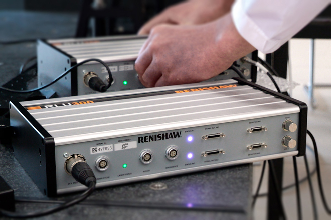

RLE300 laser unit, with 2 DI differential and 2 PMI plane mirror detector heads on white background
The RLE100, RLE200 and RLE300 systems are advanced homodyne interferometric laser encoders specifically designed for position feedback applications.

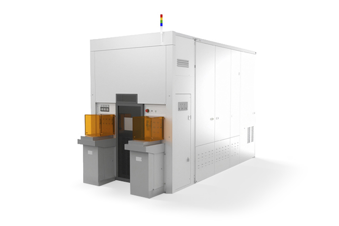

Lithography wafer inspection stage
Lithography
Laser encoders are well suited to provide precision position feedback for direct-write lithography processes, both laser write systems in air and electron-beam (e-beam) systems in vacuum.
