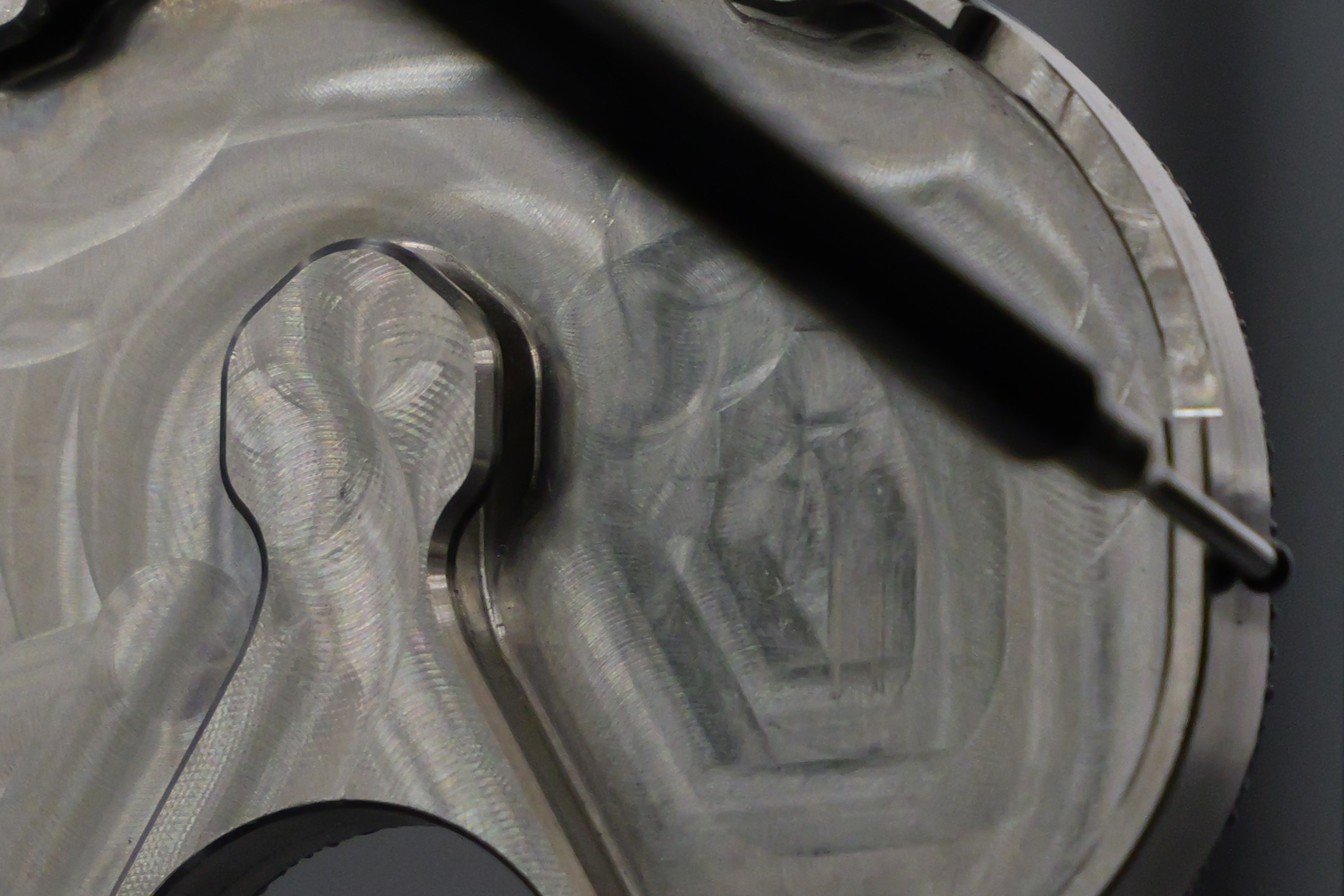

OPTiMUM diamond styli are the ideal solution for scanning applications that would normally show signs of material wear or pick-up.
To complement the REVO® system's high-performance scanning capabilities, a range of commonly used RSP2 approved styli has been created.
We have also created a range of the most common M2, M3 and M5 styli for other scanning applications.
Using industry findings, we have seen diamond out perform other ball materials in certain scanning applications. Below we have listed some applications where diamond-coated styli perform exceedingly well.

One of the standout features of our diamond-coated spheres is their ability to maintain their roundness and resist material build-up or premature wear, even when scanning abrasive materials or soft alloys. This not only extends the working life of the stylus but also reduces the need for recalibration and minimises inspection downtime.
