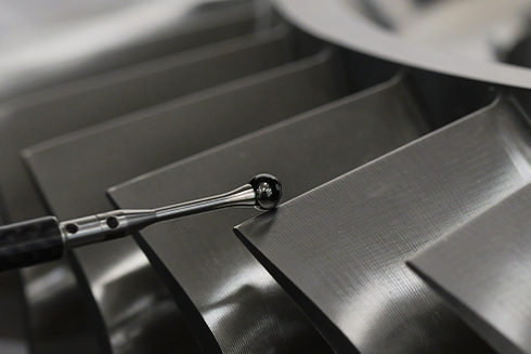

Ruby straight stylus
Our comprehensive range of styli can be used on a variety of systems. These includes Renishaw's CMM, machine tool, scanning probes, and Equator™ gauging systems. Additionally, they can be used with sensors from other manufacturers.

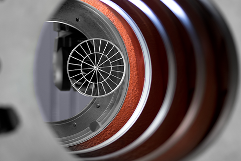

Application image: AM curved REVO stylus
Metal additive manufacturing (AM) is a flexible and powerful technology that can be used to create components and parts which cannot be made using traditional manufacturing methods. Find out how AM styli provides more measurement options than ever before.
Additively manufactured styli

What is a stylus?
A stylus is the part of the measuring system which makes contact with the component, causing the probe's mechanism to displace. The generated signal enables a measurement to be taken.
The stylus is the first link with the work piece. This is why it is vital that the stylus delivers the greatest possible accuracy at the point of contact.
The feature to be inspected dictates the type and size of stylus used. In all cases, however, maximum rigidity of the stylus and perfect sphericity of the tip are vital.
