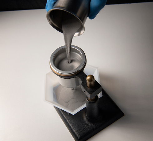

Gloved hand pouring grey liquid from metal dispenser into circular mould on black stand
Tekna produces titanium powder using RF induction plasma atomisation, a process in which titanium wire is fed into a high-temperature plasma torch. The intense heat melts the wire, transforming it into fine droplets that solidify into spherical powder particles as they cool.
This process offers significant advantages. It ensures superior sphericity, enhancing flowability and consistency in AM. The RF induction plasma process also maintains strict control over alloying elements, reducing contamination risks.
Tekna's proprietary plasma atomisation process is continuous and does not require any consumables that may interrupt or contaminate the process. Without any external gas jets or electrodes in contact with the material, the powder remains free from contaminants, making it ideal for demanding applications in aerospace, medical and industrial sectors.
Using this methodology, Tekna developed and optimised a large-cut variant of Ti64 powder. Renishaw was instrumental in validating the new powder product, working closely with Tekna by reporting the results of extensive laser parameter optimisation and powder flow testing. This workflow ensured the product met the high performance and consistency standards to perform in advanced AM machines.

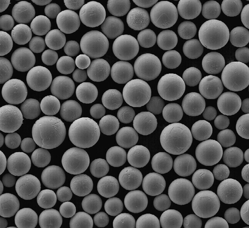

Tekna's large-cut titanium powder has immense potential for multiple applications and opens new opportunities where cost has been a barrier. The use of larger particles reduces material costs per part, making titanium AM more accessible.
Textured spherical Ti64 particles shown in close-up on a black background
Additionally, coarser powders enhance overall process sustainability by increasing yield efficiency and reducing material waste. These powders also mitigate certain health and safety concerns associated with traditional AM powders, as they are not classified as dangerous goods. Fewer safety precautions during transportation lowers logistical costs and aids operational efficiency.
By utilising a thicker 90 μm or greater layer setting, users can experience a substantial increase in printing speed compared to 30 μm or 60 μm layers. This enhancement allows for significantly improved productivity, enabling faster turnaround times. The open-architecture of Renishaw's AM systems allows for the development of bespoke parameters, including layer thickness, for specific application areas and material types.
