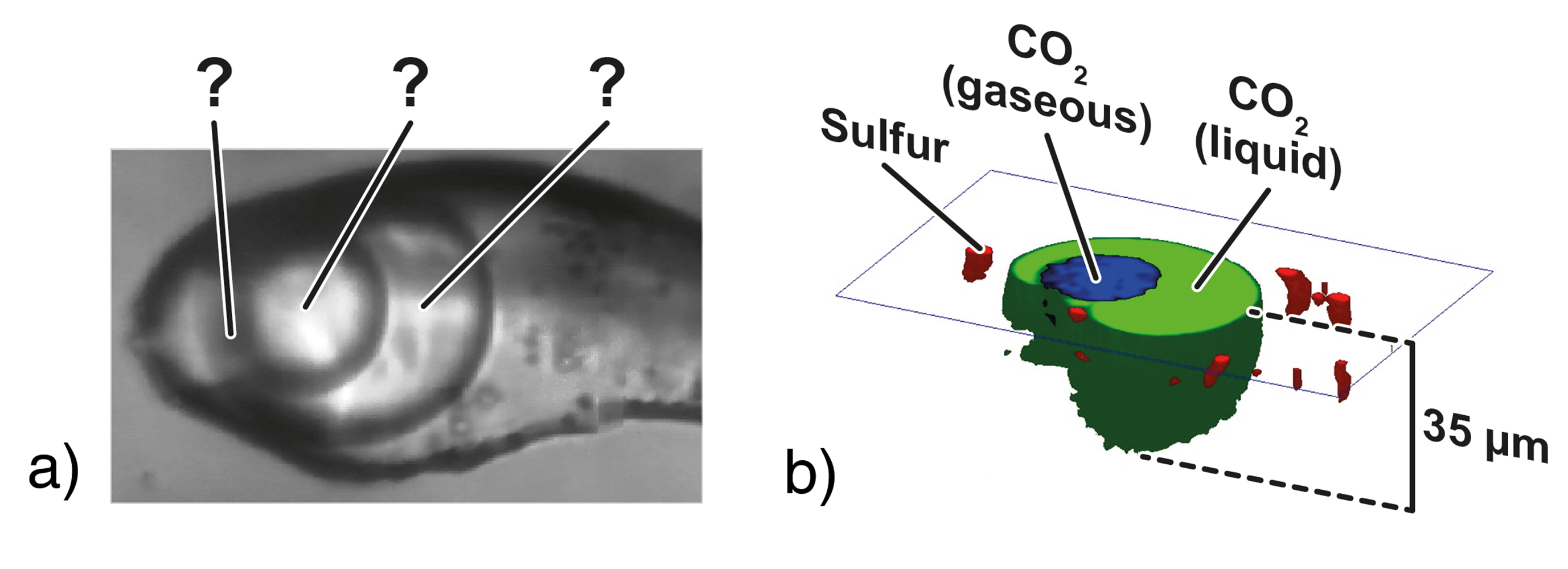

Easily determine the composition of inclusions and visualise their 3-D shape with StreamHR™ fast confocal volume imaging. You can analyse not only solid inclusions, but liquid and gaseous inclusions too.
  • Inclusion in quartz Inclusion in quartz
