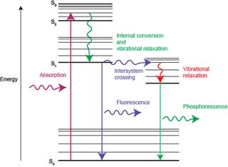

Photoluminescence includes fluorescence and phosphorescence processes. Generally, fluorescence refers to PL that is almost instantaneous and lasts less than 10 nanoseconds. On the other hand, phosphorescence refers to PL that lasts longer than 10 nanoseconds after removal of the incident light. The Jablonski diagram below helps us to understand the quantum mechanics behind fluorescence and phosphorescence.
We consider a molecule in its singlet ground state (S0). In the case of fluorescence, the molecule absorbs a photon which promotes it to a singlet excited state (S1). Fluorescent emission of light occurs when the molecule relaxes from S1 to S0. Both S1 and S0 states have the same spin multiplicity, so the transition from S1 to S0 is allowed. This is why fluorescence occurs in less than 10 nanoseconds.
For phosphorescence to occur, the molecule typically contains atoms with higher mass and a high degree of spin-orbit coupling. This increases the probability of intersystem crossing (ISC) between singlet S1 and triplet T1 electronic states. Due to the conservation of angular momentum, the relaxation from T1 to the S0 ground state is forbidden because these electronic states have different spin multiplicity. Once again, spin-orbit coupling relaxes this rule so phosphorescence can occur as a radiative transition from the T1 to the S0 state. This is why phosphorescence occurs on a much slower timescale (microseconds to thousands of seconds) than fluorescence.
In brief, fluorescence occurs when a molecule emits light from its first excited singlet state S1, after the absorption of a photon. Phosphorescence occurs when a molecule emits light from its triplet state T1 after intersystem crossing from S1.
Energy diagram showing absorption of light and the processes involved in the emission of light as fluorescence and phospEnergy diagram showing absorption of light and the processes involved in the emission of light as fluorescence and phosphorescence.

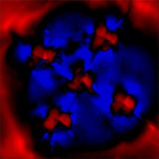

Stress image generated from the ruby R2 PL band position
Stress image generated from the ruby R2 PL band position.
