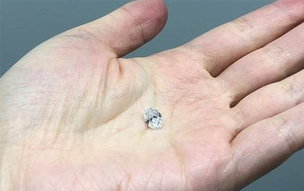

1.5 ct diamond
Figure 2 | The 1.5 ct diamond studied. Photo by Dr Tingting Gu.
More recently, an inViaTM confocal Raman microscope at the Gemmological Institute of America was used to analyse a rare IaB gem diamond from the Karowe mine in Botswana.2 Ringwoodite was identified based on the asymmetric (T2g) and symmetric (A1g) stretching of SiO4 tetrahedra at 803 and 839 cm-1, respectively. Additionally, the same Raman spectrum detected bands at 3673 and 4090 cm-1 which are due to O-H and H-H stretching modes present in the lattice structure of ringwoodite. Significantly, polyphasic inclusions of ringwoodite [(Mg,Fe)2SiO4], ferropericlase [(Mg,Fe)O] and low-Ni enstatite [MgSiO3] were observed for the first time, as shown in Figure 1.4 The equilibrium of these coexisting phases was used to calculate the temperature and pressure when these minerals were formed. The petrological analysis of this and other nearby inclusions shows that the ringwoodite originates in a water-saturated environment near the 660 km boundary. This latest work indicates a more broadly hydrated transition zone across the 660 km discontinuity and into the lower mantle.
