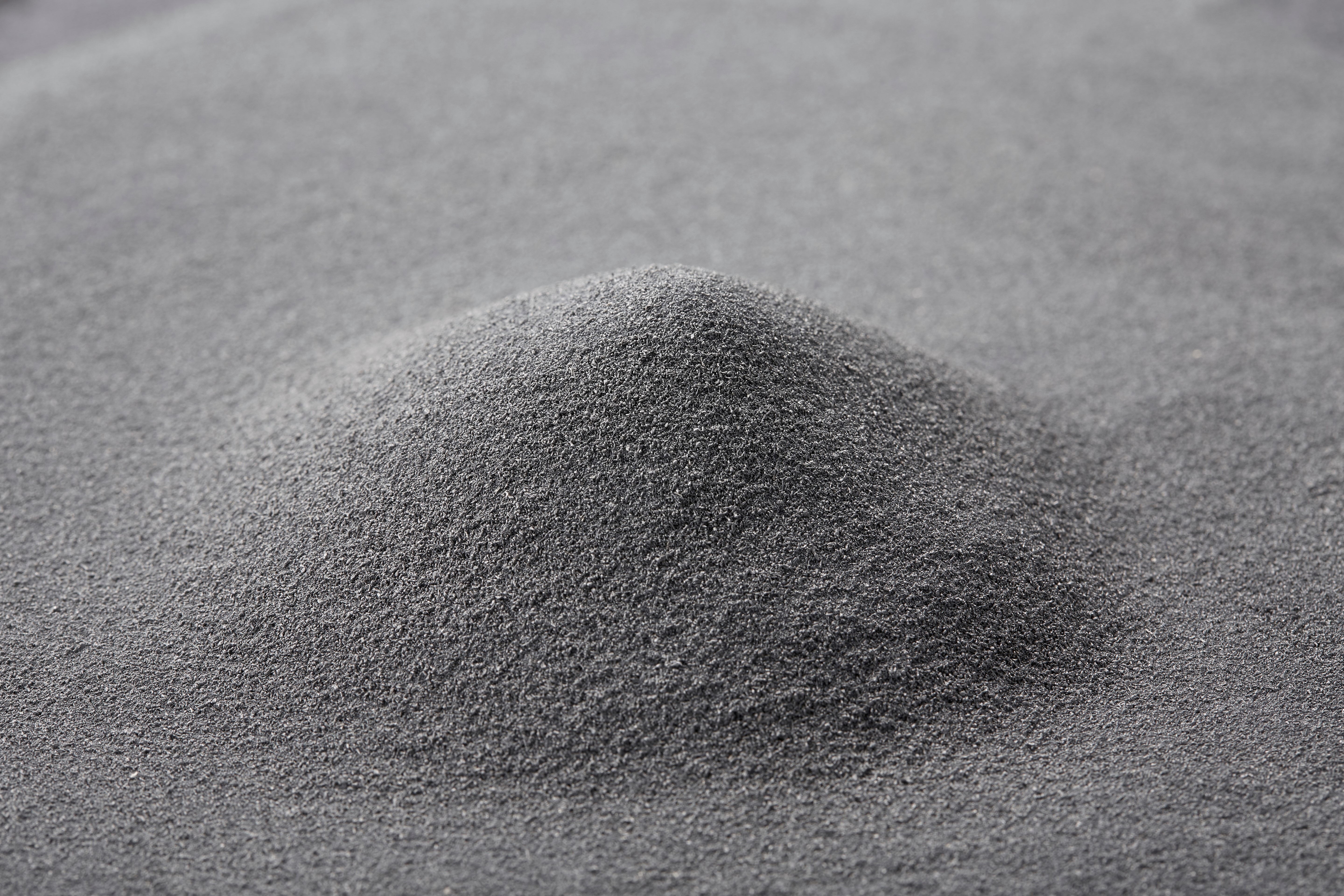

Health and safety issues are currently a barrier to moving AM from a prototyping tool kept in a remote factory location to a central part of the shop floor. Many additive processes involve the use of fine powders, such as metal or polymer powders. These powders can become airborne during the printing process or handling, posing inhalation risks. Users must therefore wear Personal Protective Equipment (PPE) like respirators, dust masks, or face shields to prevent the inhalation of potentially hazardous particles.
To maintain safety, manufacturers therefore keep their AM systems away from shop floor production, making it difficult to upscale their additive capabilities.
Keeping AM systems away from the rest of production can also slow productivity. Build times are reducing, but manufacturers must also take time removing build plates to finish parts and set the system up for a new batch by handling and sieving powder safely and resetting the machine. To ensure that manufacturers can encourage more growth, AM system developers must consider how they can overcome these barriers and develop AM technology to further improve safety and productivity.
