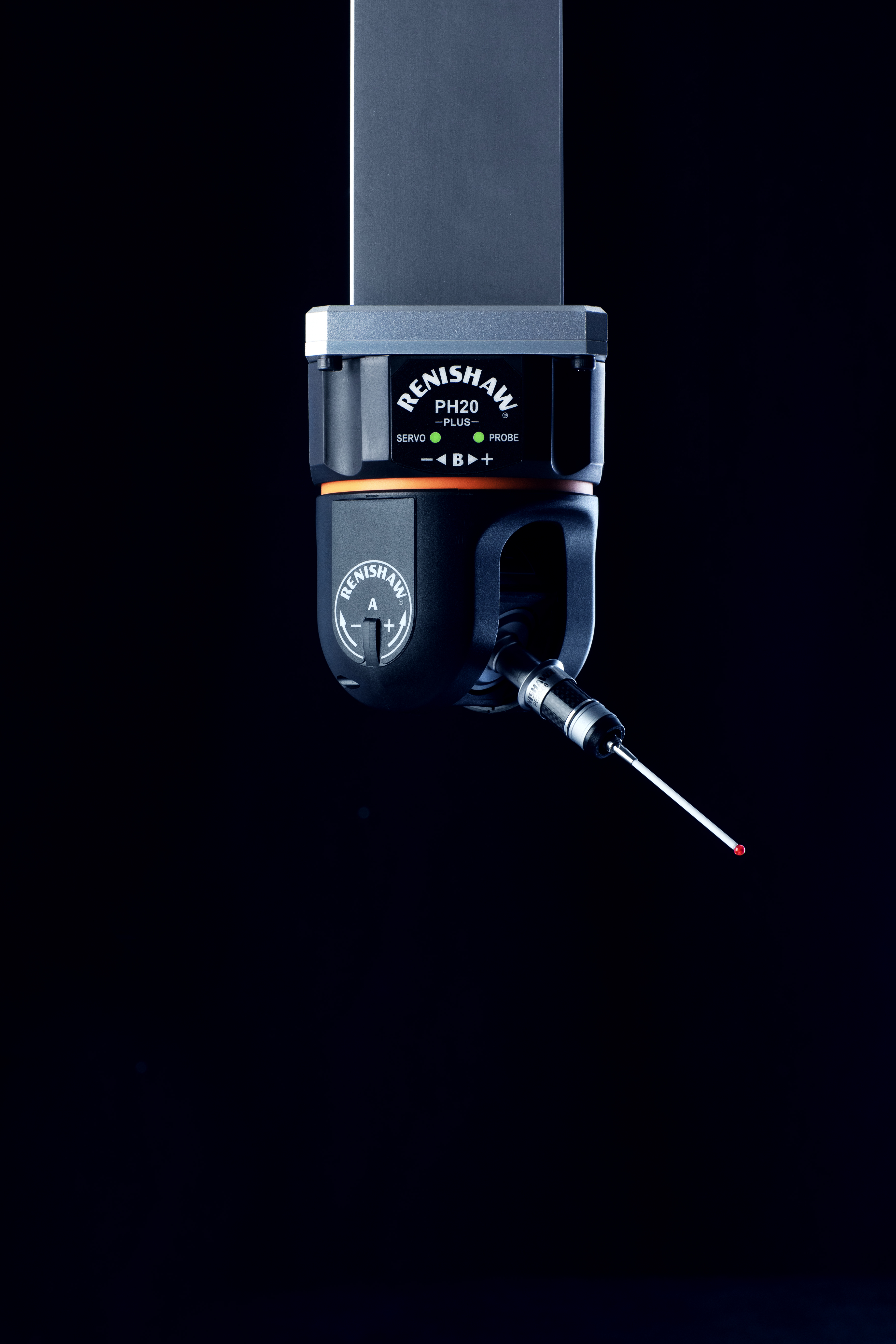

The PH20 PLUS 5-axis touch-trigger system for co-ordinate measuring machines (CMMs) is being introduced by Renishaw to replace its established PH20 head. It offers over 50% increase in inspection reach over the original head, which will improve access to features deep inside parts and in hard-to-access areas. The new PH20 PLUS system builds on the proven measurement capabilities of the PH20, enabling high-speed touch-trigger measurement across a wider range of applications.
Launched in 2010, the PH20 touch-trigger system utilises the head motion technology developed for the multi-award winning REVO® 5-axis measurement system, which minimises the dynamic errors of a CMM at higher measurement speeds. It has been widely adopted by manufacturers globally due to the substantial increases it has achieved in CMM throughput, boosted by its innovative 5-axis infinite positioning, inferred calibration routines which reduce machine downtime, and the ability to automatically change TP20 probe modules.
The new PH20 PLUS system builds on these benefits with a redesigned kinematic mount that supports longer probe configurations, improving access to part features that can be difficult to reach with the original PH20 system.

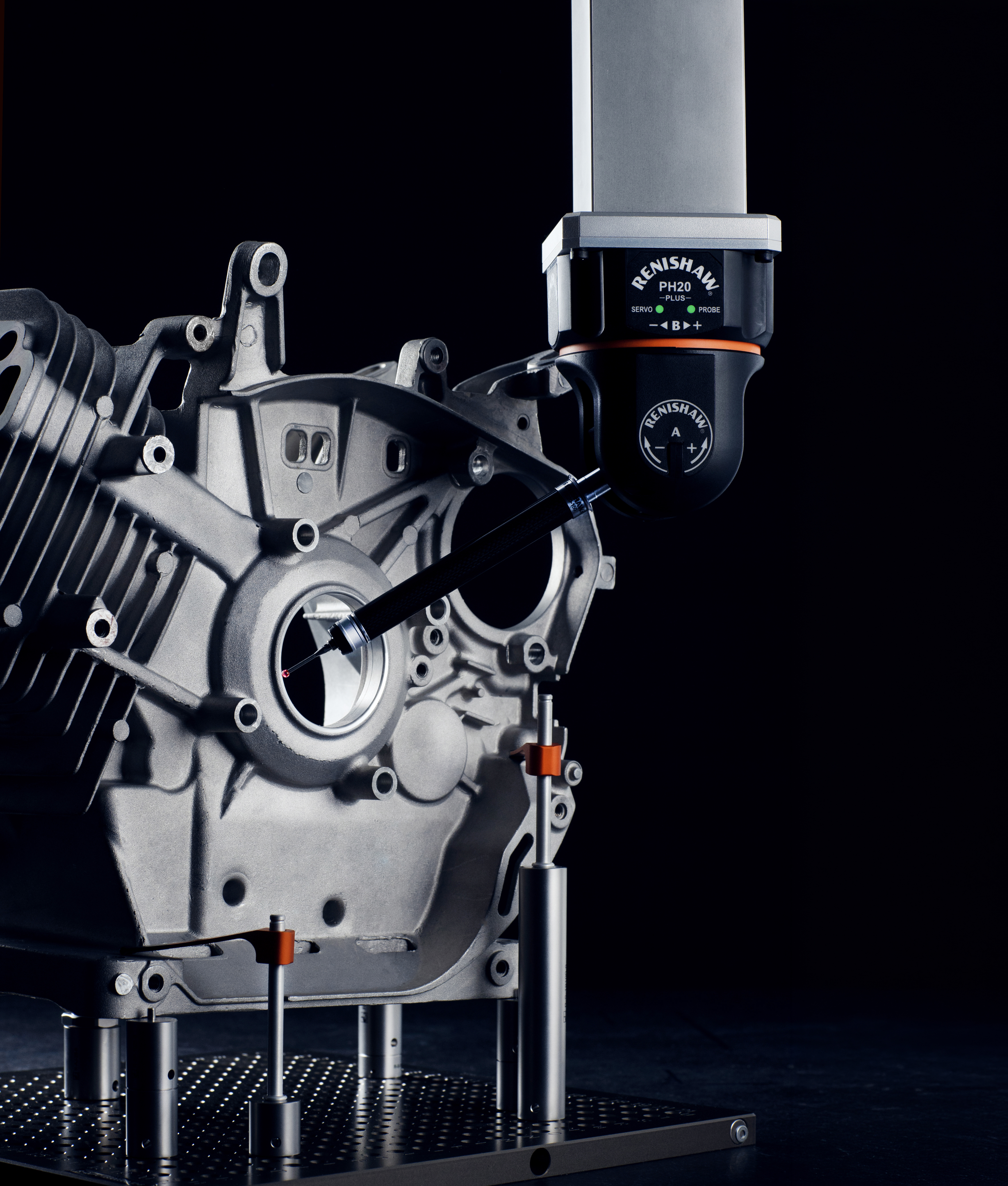

The redesigned A-axis features a new kinematic mount that supports a wider range of probe module extensions. This enables the PH20 PLUS head to use longer and heavier probe configurations giving users improved access to features deep inside parts and in hard-to-reach areas. The result is an additional 107 mm of reach, significantly increasing the accessible measurement volume without compromising usability.
With a 50 mm stylus, the PH20 PLUS head offers a maximum working length of up to 300 mm from the centre of the A-axis, an increase of over 50% compared with the current PH20 system.

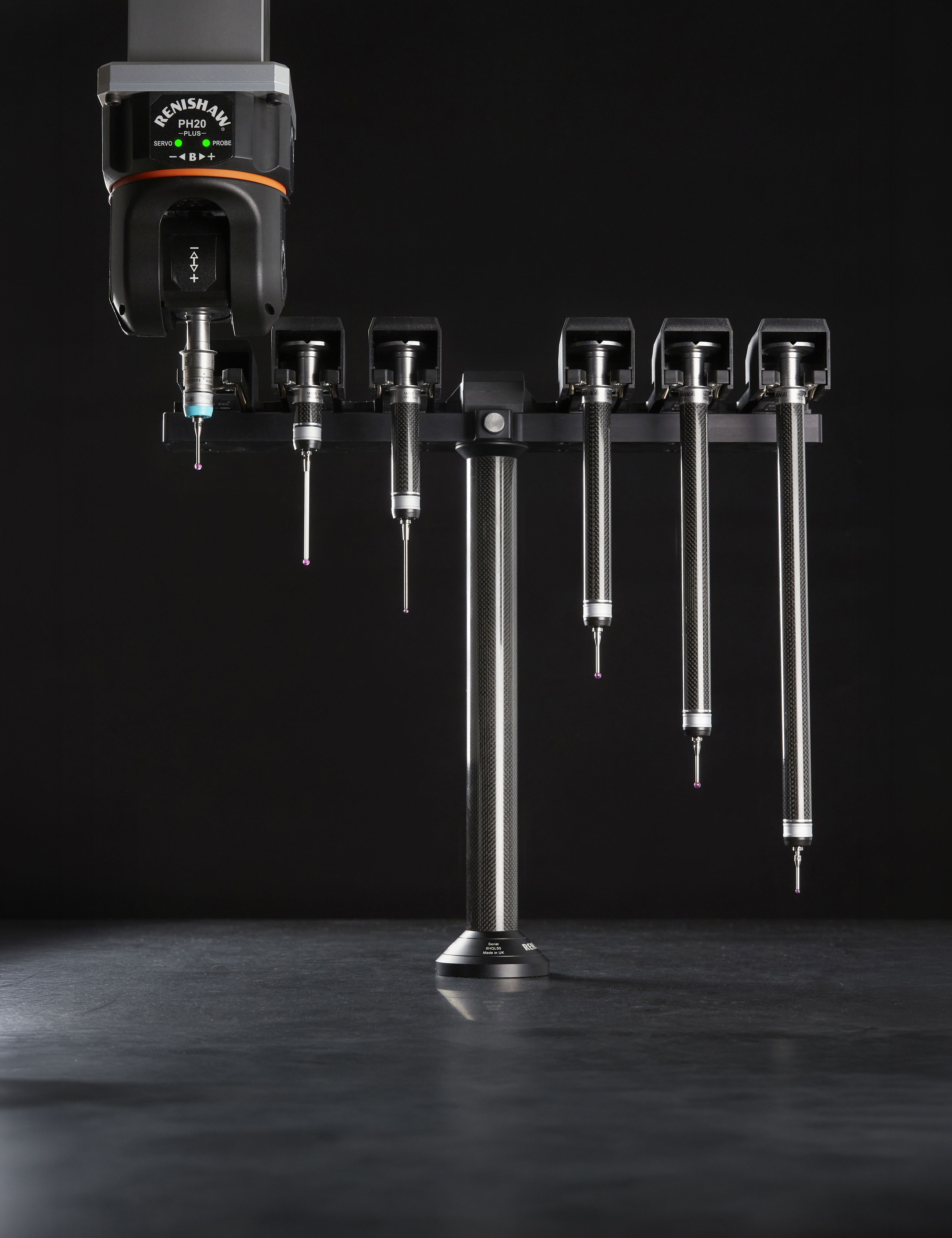

New modular rack system for automated module changing
A new modular rack system has been developed to support automatic and repeatable probe module changing with the PH20 PLUS head. The system mounts to an MRS2 rail, which can be installed on the CMM bed or directly onto the machine frame. It includes configurable change ports for TP20 modules, temperature-controlled ports for PE20 modules, and connector modules to distribute electrical power across the rack.
In addition, the powered PCR20 rack provides a standalone solution capable of holding multiple probe modules and accessories, enabling flexible configuration based on application requirements.
