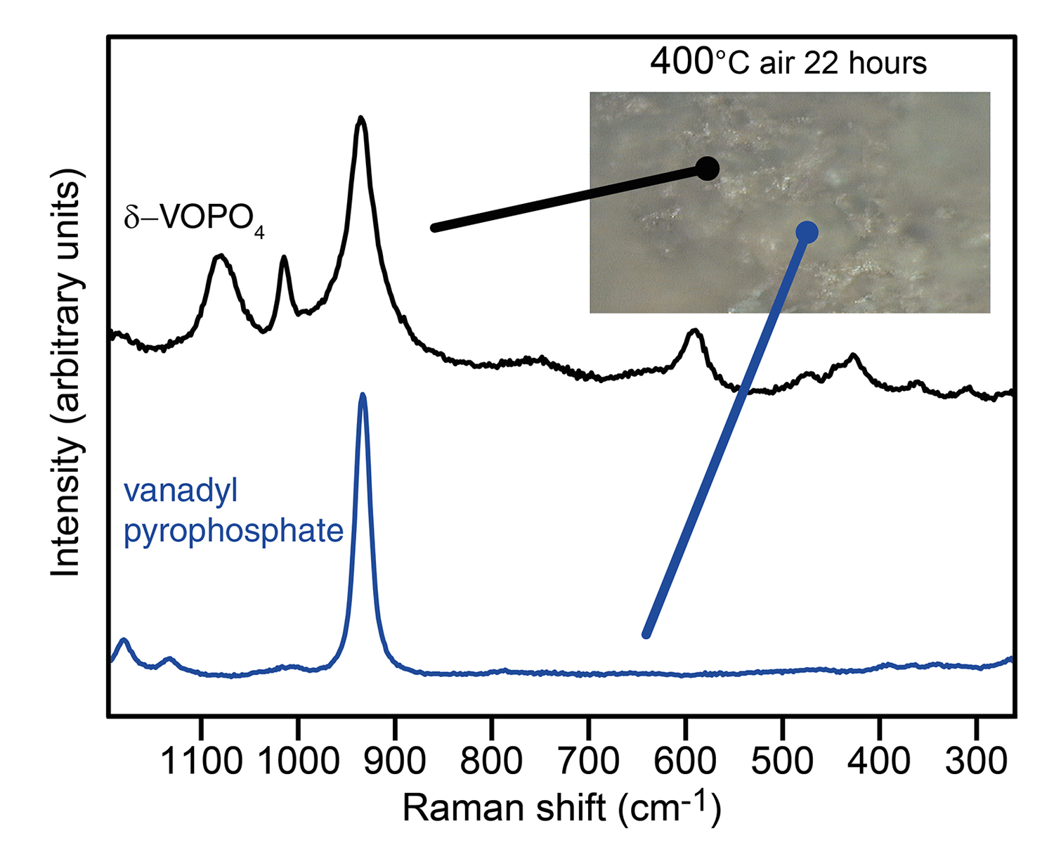

Raman spectroscopy is particularly powerful for these studies:
  • discriminate between multiple catalyst phases
  • investigate reaction mechanisms
  • conduct in situ measurements
    • in reactive environments
    • at high temperatures and pressures
    • in aqueous solutions
  • reveal by-products and other unknowns

Most catalysts are fundamentally unstable in air. Renishaw can provide suitable cells which enable you to keep your samples in the right environment. You can control temperature, humidity, and gaseous environment when performing in situ analysis.
Control the power
Some catalysts are prone to laser damage. We make it easy to select the most appropriate laser power for analysis. Renishaw also uses a line focus capability which lowers the power density of the light and reduces the risk of sample modification. You can maximise the Raman signal without having to risk laser damage, and can be confident the data accurately represent your material.
