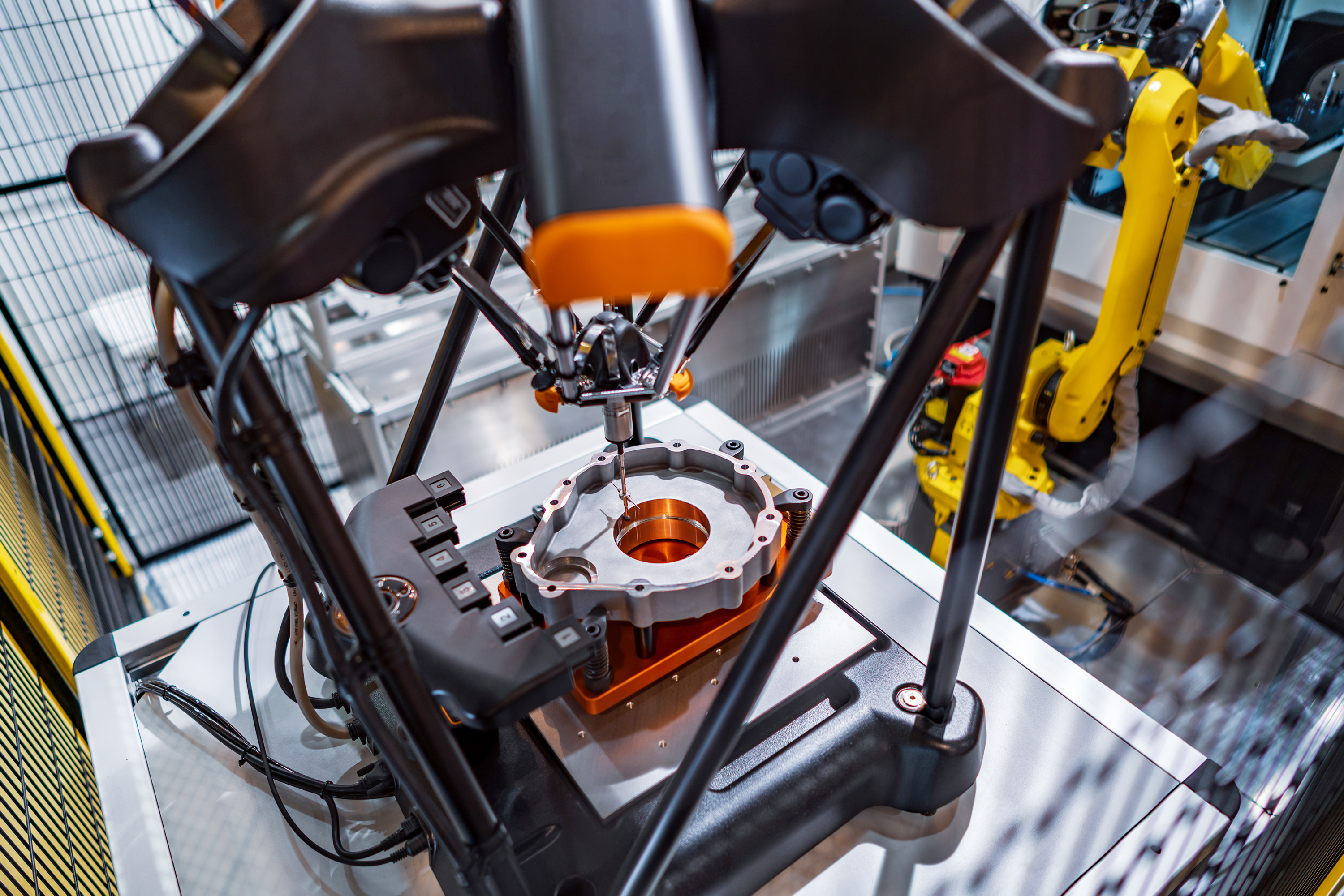

Equator gauging explained
Equator systems deliver high-speed comparative gauging for the inspection of medium to high-volume manufactured parts in key applications across multiple industries, for example transmission components for automotive and landing gear for aerospace.
It is a fast, highly repeatable, and versatile gauge designed for shopfloor use.
Ben Spokes, Renishaw Business Development Manager for Equator gauging, explains: “The largest market for Equator gauging systems is automotive, with hundreds of Equator systems in use globally for electric vehicle part inspection. These are often used with fully automated loading and direct intelligent process control, that can improve the quality of manufactured parts, and significantly reduce or even eliminate scrap.”

The Equator system can operate at a temperature range of 5 – 50°C and up to 80% humidity and has been optimised for part loading via a robot or shuttle system. Configured for easy communication between the system and a variety of automated work cell equipment, integration into an automated cell is simplified. The result is significantly reduced cycle times, improved productivity and increased throughput.
Introducing flexible gauging close to the point of manufacture also allows the validation of discrete machining operations, enabling automated process control and tool offset management. This leads to increased confidence in final part quality.

Equator gauging systems are optimised for enhanced machine connectivity. Automation software and hardware have been developed to improve integration in automated cells.
The REN-IO interface unit, coupled with the EZ-IO automation software, allows the Equator gauge to connect to a variety of external equipment in an automated cell with up to 32 digital IO connections. EZ-IO software simplifies the setup of automated manufacturing cells to configure communications between Equator systems and the cell controller.
