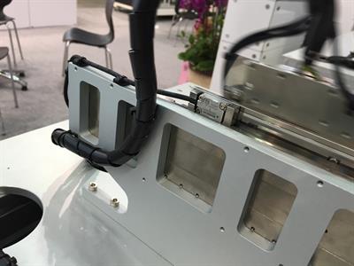

ATOM™ on linear stage

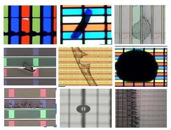

Panel defects
As modern FPD manufacturing techniques become more complex and difficult, panel defects are increasingly likely. Robust inspection and repair procedures have been developed to ensure that errors, where they do occur, have minimal effect on display quality. Processes needing repair operations in liquid crystal display (LCD) manufacturing, for instance, include those involving thin film transistor (TFT) substrates, colour filter (CF) substrates and TFT / CF alignment (cell assembly).
Damage to any one of the millions of transistors within the LCD panel may leave a sub-pixel permanently on or off, creating a tiny dark or bright spot on the display. Broken or shorted TFT data lines are often the cause of bright / black line defects. Repair structures integrated into the TFT layer allow white pixel defects to be turned to ‘black' or ‘dull' by irradiation with a laser. The laser is used in ablation / welding and is focused on the defect to either vaporize it or to create new contacts in the case of TFT repair. The spot-size (diameter) of the laser beam needs to be carefully controlled so as to encompass the defect but leave the normal substrate around it undamaged. Precise manipulation of the laser aperture, in the range of 5 – 50 microns (µm) in diameter, is vital to ensure successful panel repair and improved process yield.

Mr Hyun-Joo Hwang, director of TPC Motion, explains: “The laser aperture stop consists of four moving vanes arranged in crossed pairs. Each vane is driven by an individual voice coil motor with a maximum travel of only 2 mm.
Banner: TPC Case Study
All four voice coil motors are equipped with an ATOM encoder system for position feedback control. For this application, we selected the ATOM encoder with 50 nm resolution and RTLF tape scale. The accuracy of ATOM allows us to precisely control aperture sizes ranging from 5 x 5 µm to 50 x 50 µm. Before attempting to repair a defect, the aperture size is pre-set and then remains unchanged until the next repair operation."

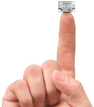

ATOM™ on index finger
TPC designed its aperture stop assembly to be as compact as possible, in order to fit inside a small imposed footprint. Clearly, consideration of the physical size of the chosen encoder system was essential to meet this criterion.
Mr Hwang continues: “The laser repair tool rapidly tracks back and forth across the panel to the location of every defect, which necessitates a light weight design to maximise throughput. The aperture assembly accommodates four voice coil motors, each with an ATOM encoder, all enclosed within an area of approx. 100 mm square. ATOM's best-in-class feedback performance provides improvements in aperture control, whilst the low mass (<4 g) of the readhead ensures that overall design weight remains uncompromised.”

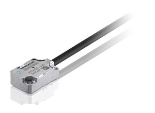

ATOM's miniature readhead is only 7.3 mm x 20.5 mm x 12.7 mm (FPC cable variant) and is ideal for applications with limited space.
