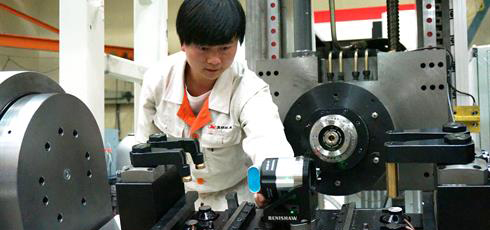

Rotary axis calibration on a Kunming machine tool using XR20-W

Rotary axes are becoming more popular in use with the growth in 5-axis machine tools. Conventional rotary axis assessment is not only time consuming but also requires skilled operators. Mr Yang said “We used to adopt a multi-tooth indexing table working with a quasi laser tube or a 24 face prism with auto-collimator to measure positioning accuracy of rotary axes. During the measurement, the upper half of the multi-tooth indexing table is lifted off manually and turned to a defined measuring angle. Then, we counter rotate the rotary table by the same angle to re-align with the laser tube. As a result, the errors can be measured. The accuracy of this approach is quite high, up to ±0.2 arc seconds but the tradeoff is time consumed; even an experienced technician has to spend one day to complete the measurement. The 24 face prism projects images on its reflective surface via the light tube. However the limitation is the measuring angle interval must be a multiple of 15 degrees.

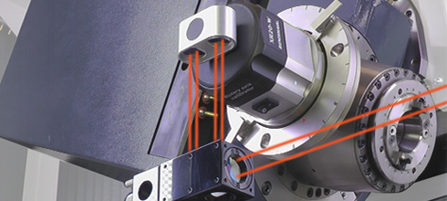

XR20-W rotary calibrator off axis
The Renishaw XR20-W rotary axis calibrator has transformed the way we calibrate rotary axes on machine tools. The XR20-W works with the XL-80 laser, allowing the measurement to be completed within 2 hours, reducing labour costs. The operation is quite simple, available with a software user interface in Chinese language, where operators with basic computer knowledge are able to get started quickly."
The Renishaw XR20-W rotary axis calibrator employs wireless operation where data capture is synchronized to axis movement, with accuracy up to ±1 arc second, allowing automated measurement at any defined angle interval. All calibrators are factory calibrated and delivered with traceable certification. The XR20-W also supports off-axis measurement, allowing measurement even when the calibrator is not directly installed on the rotary axis pivot point. It is one of the frequently used functions by KMTC.
