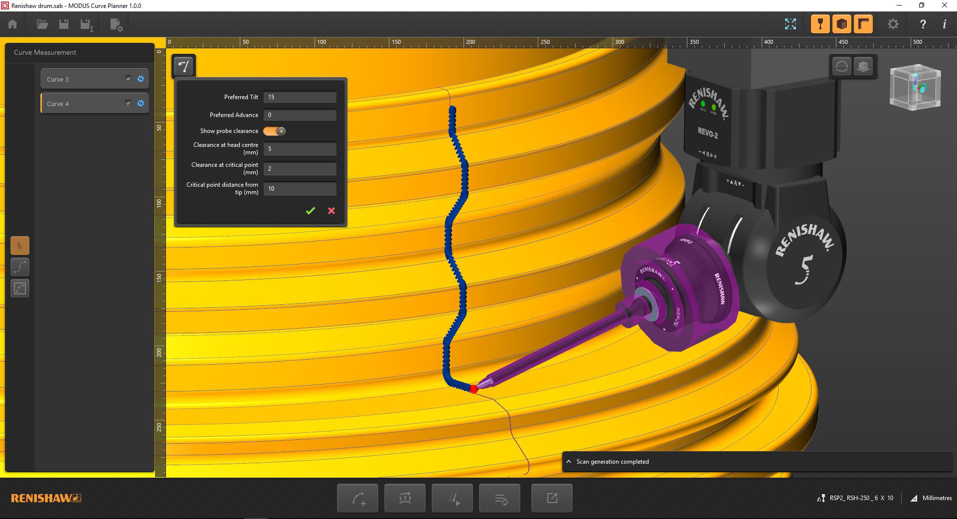

Software is an integral element of the REVO 5-axis measurement solution, and Renishaw's MODUS™ metrology software delivers high-performance industrial inspection, optimizing the performance of the REVO multi-sensor measurement system.
MODUS 1.13 software offers multiple enhancements in flexibility and usability for REVO sensors. Users can benefit from powerful new features within its specialist programming (MODUS Planning Suite) and reporting (MODUS CHART) tools.
