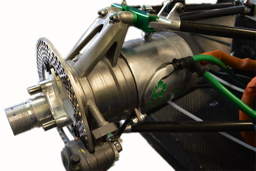

  • Renishaw supports Brunel Racing in Formula Student competition
