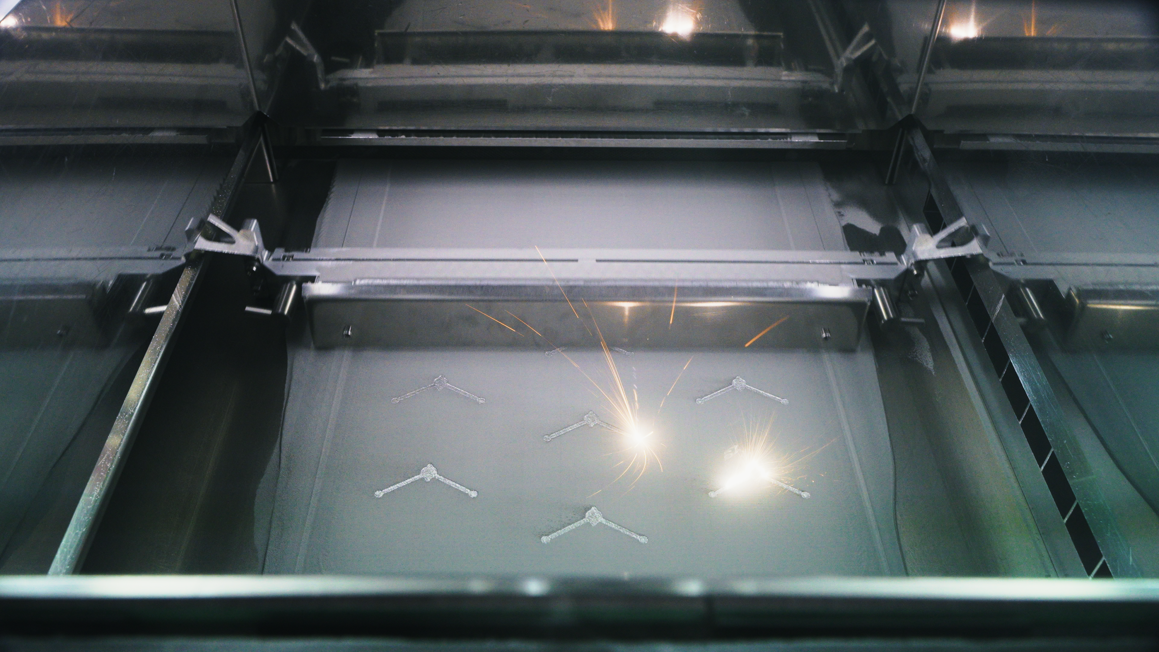

TEMPUS™ technology, a new innovation from Renishaw, incorporates a new scanning algorithm for the company's RenAM 500 series of AM systems, which allows the laser to fire while the recoater is moving, enabling savings of up to nine seconds per layer. Over the course of the build, the time saving adds up significantly. Higher time savings are typically achieved when building parts with thin, vertical features, but all part geometries can experience some productivity benefits.

Tibial tray build with TEMPUS™ technology
