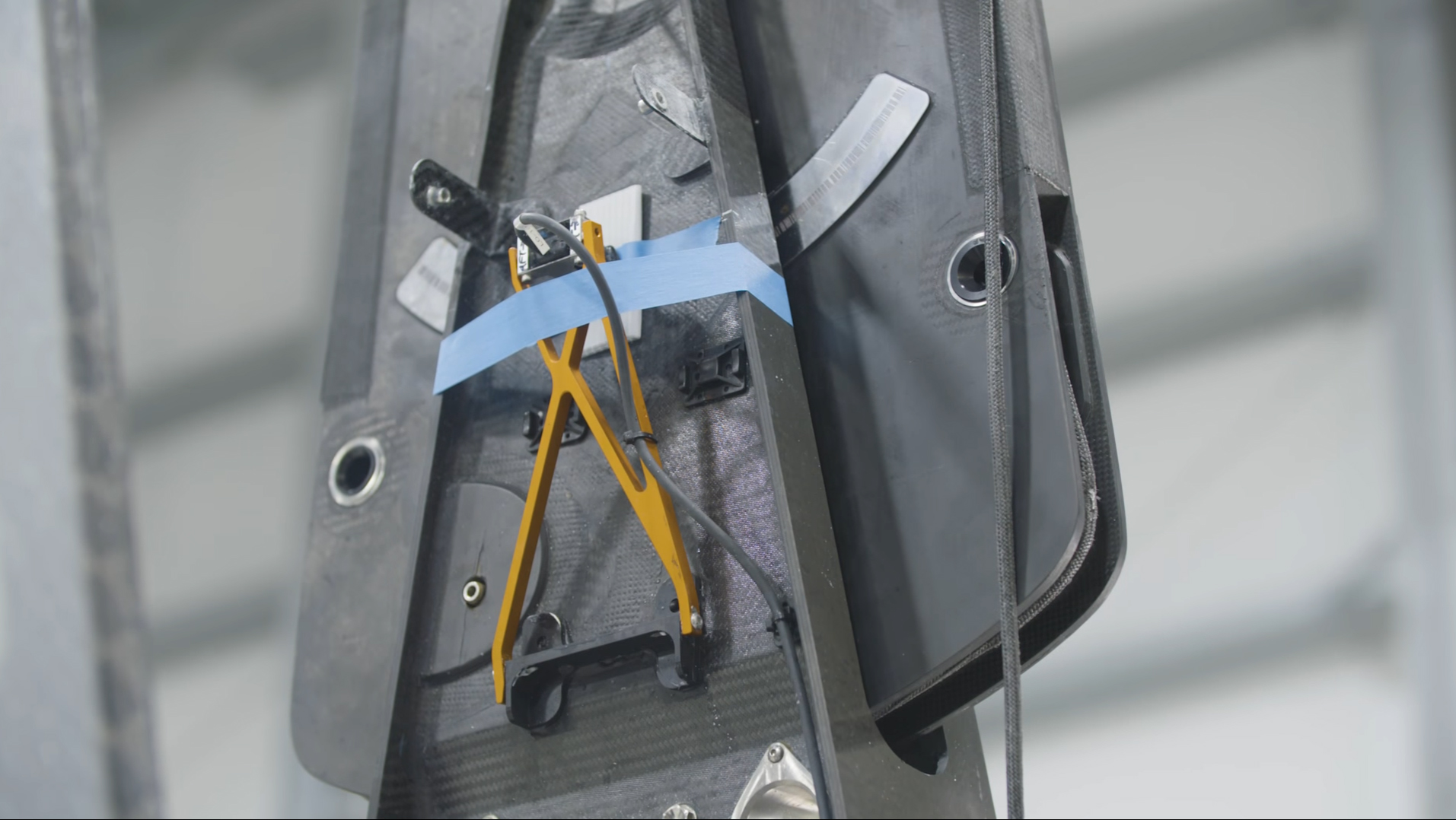

Land Rover BAR encoder installed on the control surface on wingThe encoders installed on a hammerhead (flap control plate)

The design process was based primarily around the requirements of the encoder. Up on the wing, a small amount of mass at the top makes a big difference to the performance and stability of the boat. Space was a prime consideration – the space restriction came about because the actuation surfaces are in small spaces with small clearances. At the same time, this wing is approx. 24 m high and is designed to twist by varying amounts at different heights for aerodynamic reasons. What we must contend with is the fact that when the scale plate on the hammerhead moves around, it rotates out-of-plane as well due to the twist of the wing.
Our traditional encoders are designed to run with moderately small ride-heights on good linear or rotary axes. Here we have a tight requirement in terms of measurement accuracy along an arc that is not just moving axially but also twisting as it rotates. We had to come up with a way of maintaining the measurement accuracy throughout the out-of-plane twisting and pitching. Magnetic sensors are arguably the best technology to use in terms of contamination resistance, although ride height tolerance is very tight compared with typical bearing movements in a boat and wing of this size.
Understanding Land Rover BAR's requirements was the most important aspect, but given the time restriction, we had to select technology from building blocks that we already had from pre-existing commercial encoders. Space and geometry requirements in the wing were significant factors in determining the design. Each part was a real challenge; we started with a module that exists for a linear encoder for use on a precision plated shaft with carefully shaped grooves embedded under the surface. We had to effectively unwrap that code and embed it into a flat surface with differently shaped grooves along an arc using a new process and hope that the resulting flat arc equivalent scale would work first time.
We took the pre-existing LinACE™ module from our RLS associate company, and repackaged it into a waterproof encapsulation, which we hadn't done before, to allow it to survive the operating environment. This also provided an encoder body which was small enough to operate within the tight dimensional constraints of the highly stressed wing ribs. We also had to come up with a solution that allowed the scale part to twist and move but without inducing significant errors when the sensor moved.
Close up of scale and readheadThe wing encoder solution
What was your solution?
We had to come up with a gimbal arrangement for the sensor whereby the partial-arc scale can twist out of its plane of rotation without inducing inaccuracy. A special aluminium wishbone and yoke assembly was designed to hold the readhead with high precision while allowing for pitch and roll. The wishbone is attached to the wing's static structure. This whole encoder assembly gives a much more accurate reading of the position of each flap than inferring from actuator movements.
