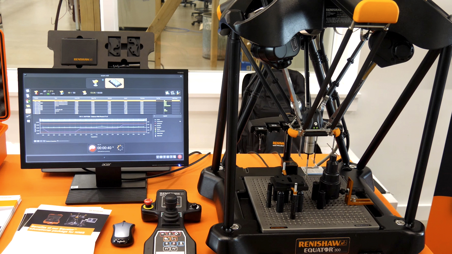

The Equator gauge is a flexible system that provides speed, repeatability, and ease of use for manual or automated measurement in machine shop environments. Its integral re-mastering process also means that the Equator system does not require annual machine calibration.
The prewritten programs include proven gauging programs for each part required for NIMS certification. The package also includes styli, two metrology fixturing plates, and fixtures that can fit all 13 parts, providing everything needed to inspect the parts. The system also features a user-friendly operator interface, allowing easy program selection and execution, and a clear display of results.

Renishaw’s Equator gauging system inspecting a NIMS machined part
Renishaw's Equator gauging system inspecting a NIMS machined part
