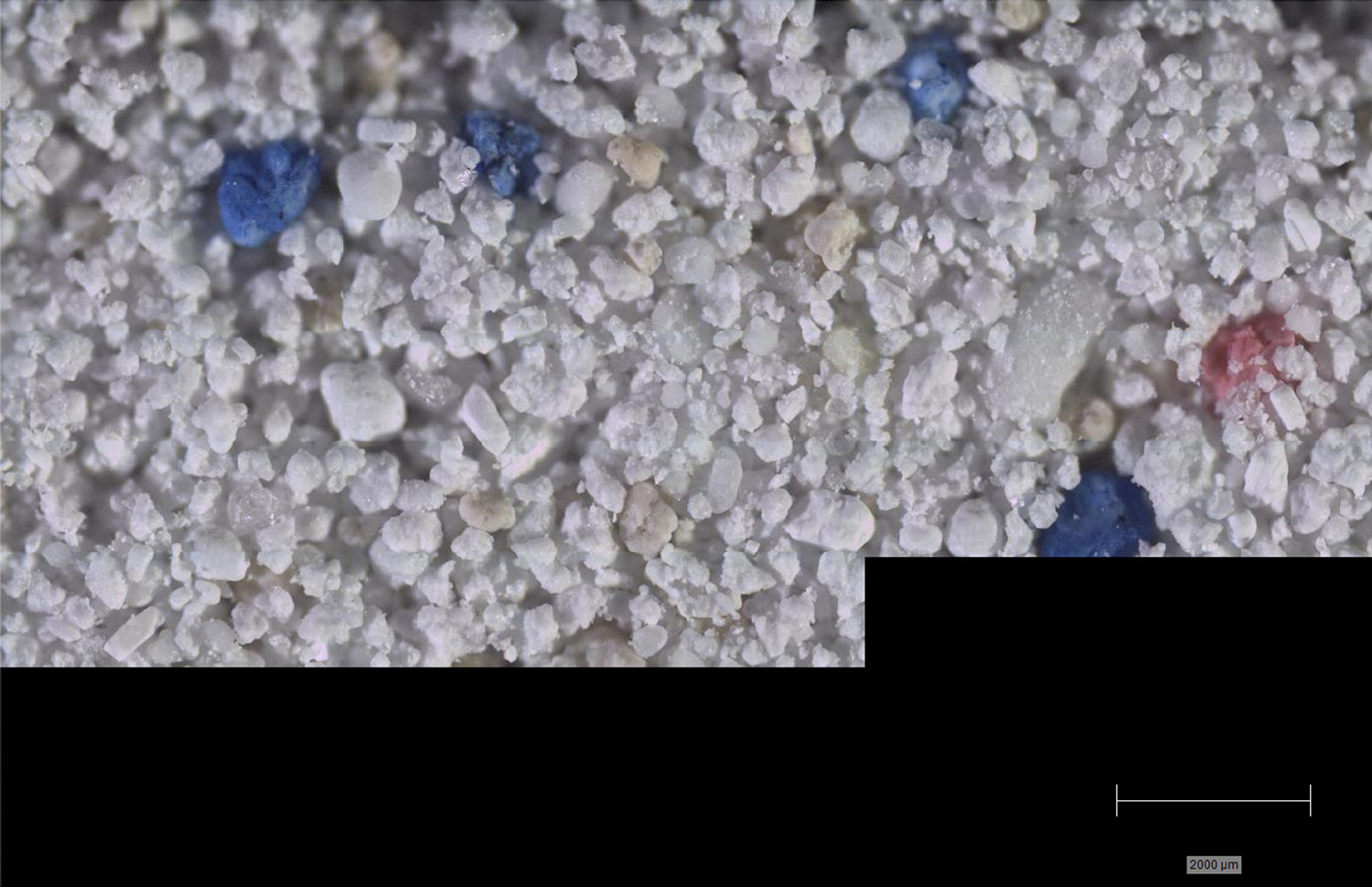

  • Automatically capture white light images from reflected or transmitted white light. These images can be stored with your spectral data
  • Create high resolution white light images over large areas by using WiRE's white light montaging (tiling)
