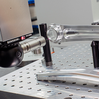

  • Renishaw PH10 / SP25M and modular fixturing contribute to Hope’s quality control process

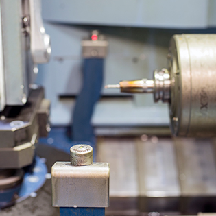

  • Renishaw NC4 system helping to reduce downtime on Hope Technology’s Matsuura machine
“The Renishaw NC4 system is deployed on all of our Matsuura machines,” states Mr Pate. “They run 24-7 unmanned. If a tool breakage alarm sounds, the machine stops to prevent producing parts using a damaged cutter. As a result, the Renishaw NC4 system serves many purposes: it ensures product integrity, eliminates costly scrap, and also the possibility of a broken spindle, which would be hugely expensive to replace in such high-end machines. We do everything we can to avoid downtime. The consequences could be severe. After all, to keep inventory costs down, we only hold an hour's worth of stock at any one time!”
The NC4 is a flexible laser-based system with ultra-compact laser tool setting transmitter and receiver units that can be mounted on separate brackets, or as a single fixed unit. Dependent on the system, separation distances and mounting, tools as small as 0.03 mm diameter can be measured at any selected point along the beam.

“It's a high-volume production environment, which means it is critical that we maintain production flows,” reiterates Mr Pate. “Renishaw technology is vital to the process and also to part inspection. We take components off the line on a regular basis for sample measurement on the CMM, using the Renishaw PH10/SP25 head and probe. We also check the first-off from each run, to make sure nothing has changed since we last made the part. If we know the part is good, that's great. If the CMM shows up errors we change the program or the tools, press cycle-start and walk away. The Renishaw products give us the confidence we need.”
