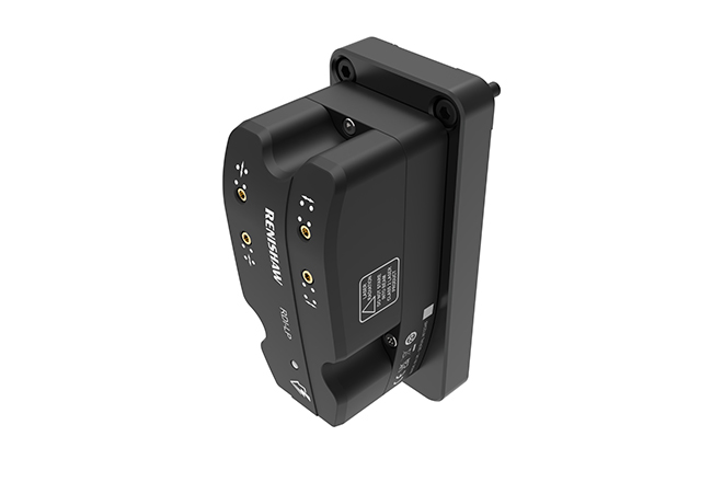

15 mm DI periscope
The 15 mm DI periscope assembly contains two mirrors which increase the offset between measurement and reference beams of the DI differential interferometer detector head by 15 mm. This 15 mm offset produces a beam separation of 29 mm as opposed to the 14 mm beam separation provided by the differential interferometer alone.
Features and benefits
  • Adapts the DI beam layout for applications requiring wider mirror spacing.
  • Increases beam separation from 14 mm to 29 mm.
  • Simple, fixed-offset design with no additional adjustment required.
  • Easy to integrate, mounting directly to the machine structure using the three screws provided.
