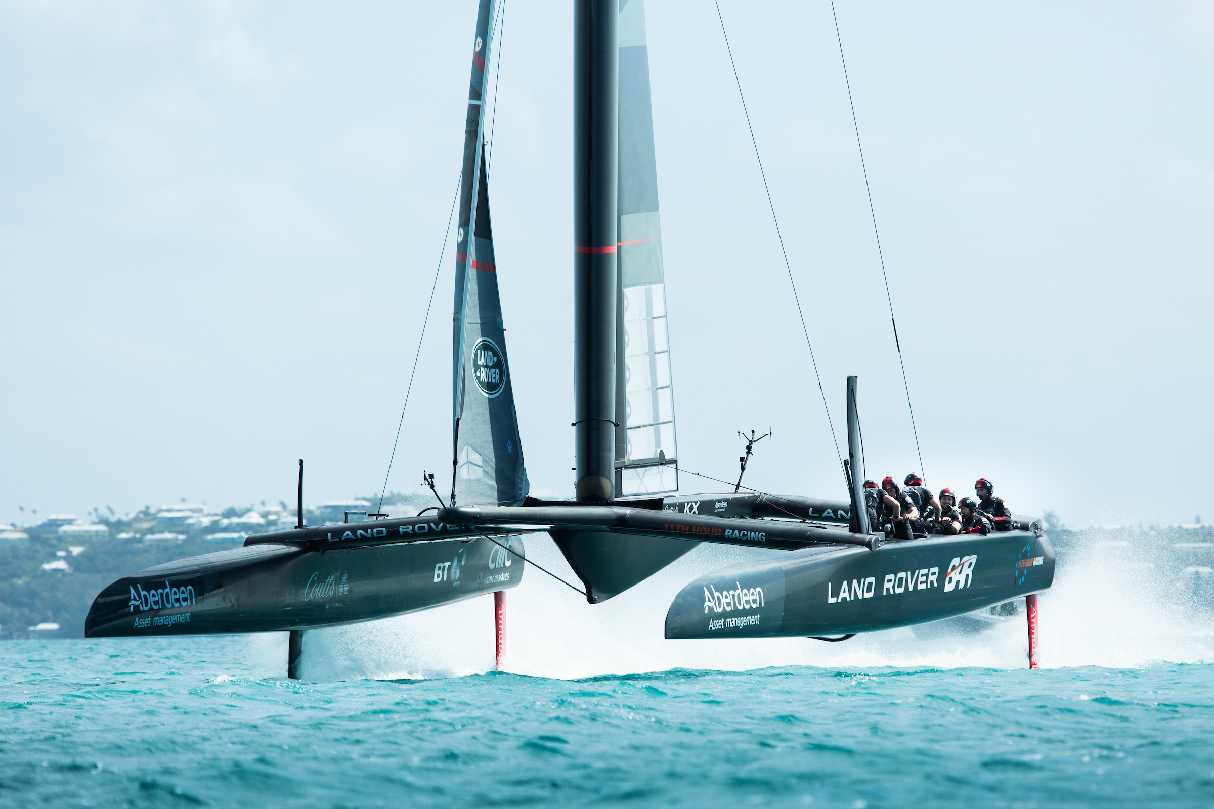

LR BAR custom height at speed.The R1 at speed in Bermuda
